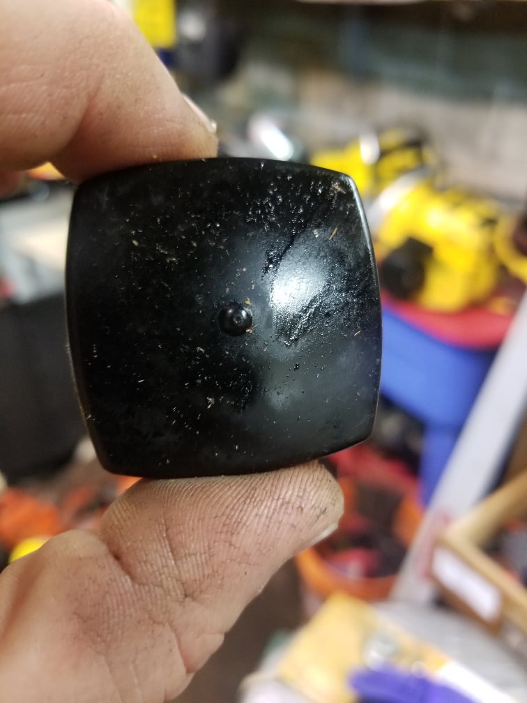

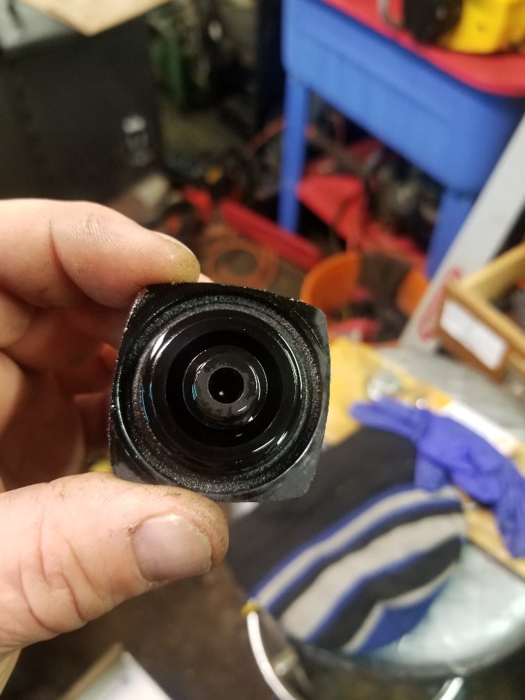

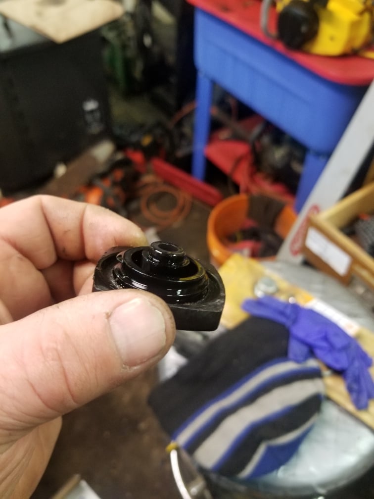

I decided to go out and cut some with the 4-10. I made 2 cuts and realized I forgot my tuning screw driver in the garage. Walked back to the garage with the saw running in my hand, grabbed the screwdriver and headed back to the log pile. The saw died on the way to the log pile and i couldn't get it to restart. Back at the garage, spark would jump a spark plug but not my spark tester unless I spun the motor quite fast with my drill. I figured the chip died (have heard all the warnings) but wanted to try it anyway. So I cleaned up the original points and put them back I and gapped them. Had great spark. Put it back together and it fired right up. Great!! Had to go in for dinner, came out after dinner, saw fired but would die when I tried to rev it. Checked spark again and it is inconsistent unless I spin the motor fast with a drill. What am I missing here? Is this a coil issue? I've always had coils either fail or not.
Also, is this fuel cap repairable?
Had a few bad condensers do that.
I have a cp55 here that is doing the same thing. I have replaced everything but the coil at this point. Just fed up with it. Never seen a bad mac points coil. But untill i replace it to confirm it, you and i may have the first two!
Best way to fix that cap is to throw another in the box coming to you. ;)
I have had a bad Mac points coil for an sp125, it was breaking up and then died
Ya coil, it’s going bad when hot, if the chip and points both have the same problem it’s the coil! I have one saw that has both points and chip, I can switch back and forth to test coils
