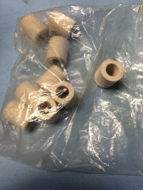

I have a couple questions. Where could I find the fuel filter element for a 250. I got one a couple weeks ago and the element wasn't there. Also inside the fuel cap of my pm 850 looks like there may have been a duckbill valve or something? It leaks fuel heavily out of the cap. Thanks for any help.

On the 250 it depends on what style it is .If it's the big filter that resembles a large cigarette filter try MFG supply.on the net .Fact that company has many filter options .

That's the one. Thank you.
This kind?
The big Walbro 'klunk' filter.

Felt element slips in there, Bailey's used to have them for around $4.00
There does need to be a duckbill in the 10Series fuel cap, the red Homelite valve makes a good replacement.
Mark
Thank you sir
