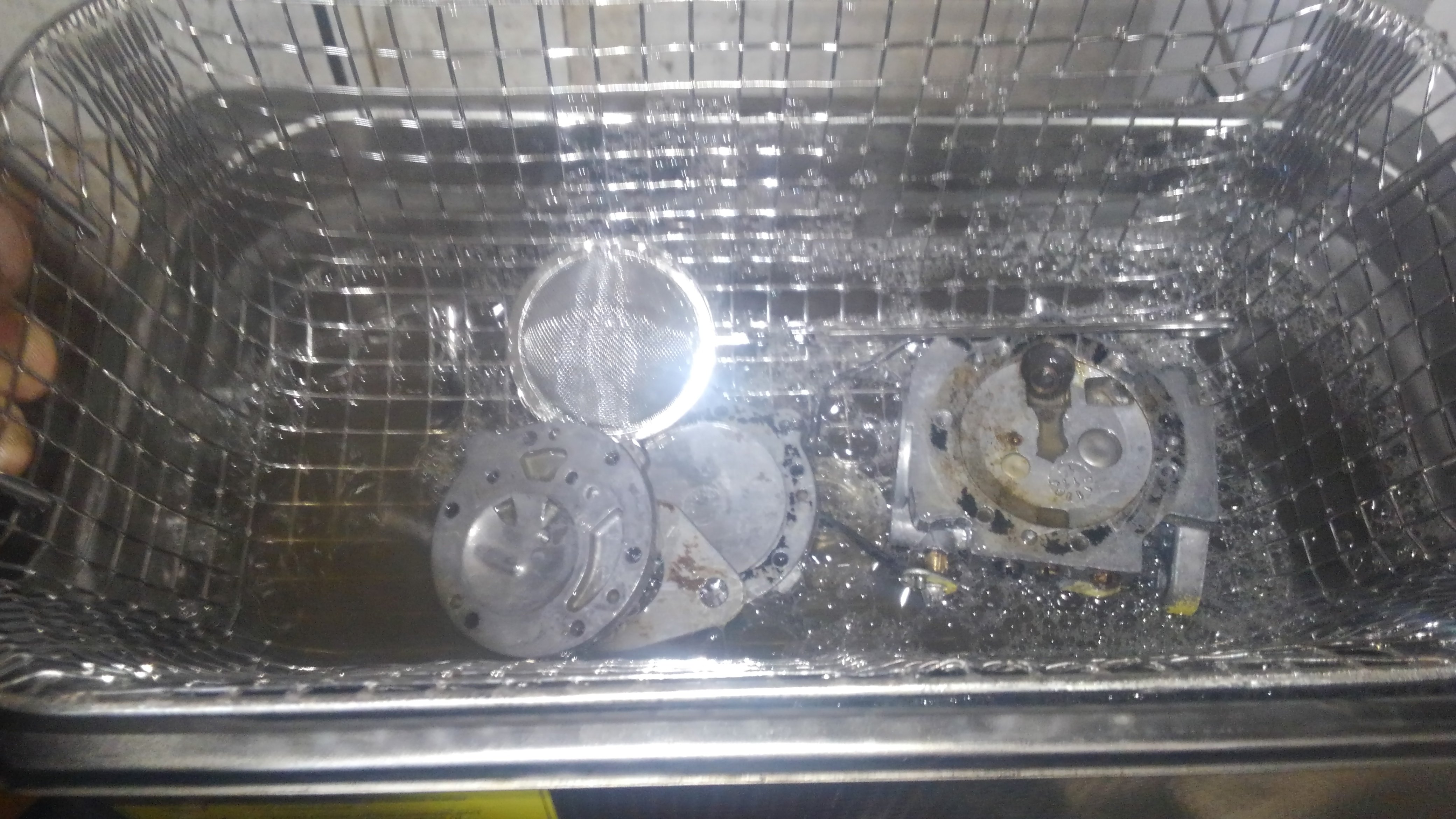

WillG
3:09 AM
10686
Oct 10, 2019
1,730
9,060
Norwich CT
A bit more progress on the 1-50 tonight. Fuel tank flushed, new fuel lines and filter installed, and the carb went for a 2 hour swim in the ultrasonic cleaner. Will reassemble the carb tomorrow afternoon and then I will see if she's going to run!

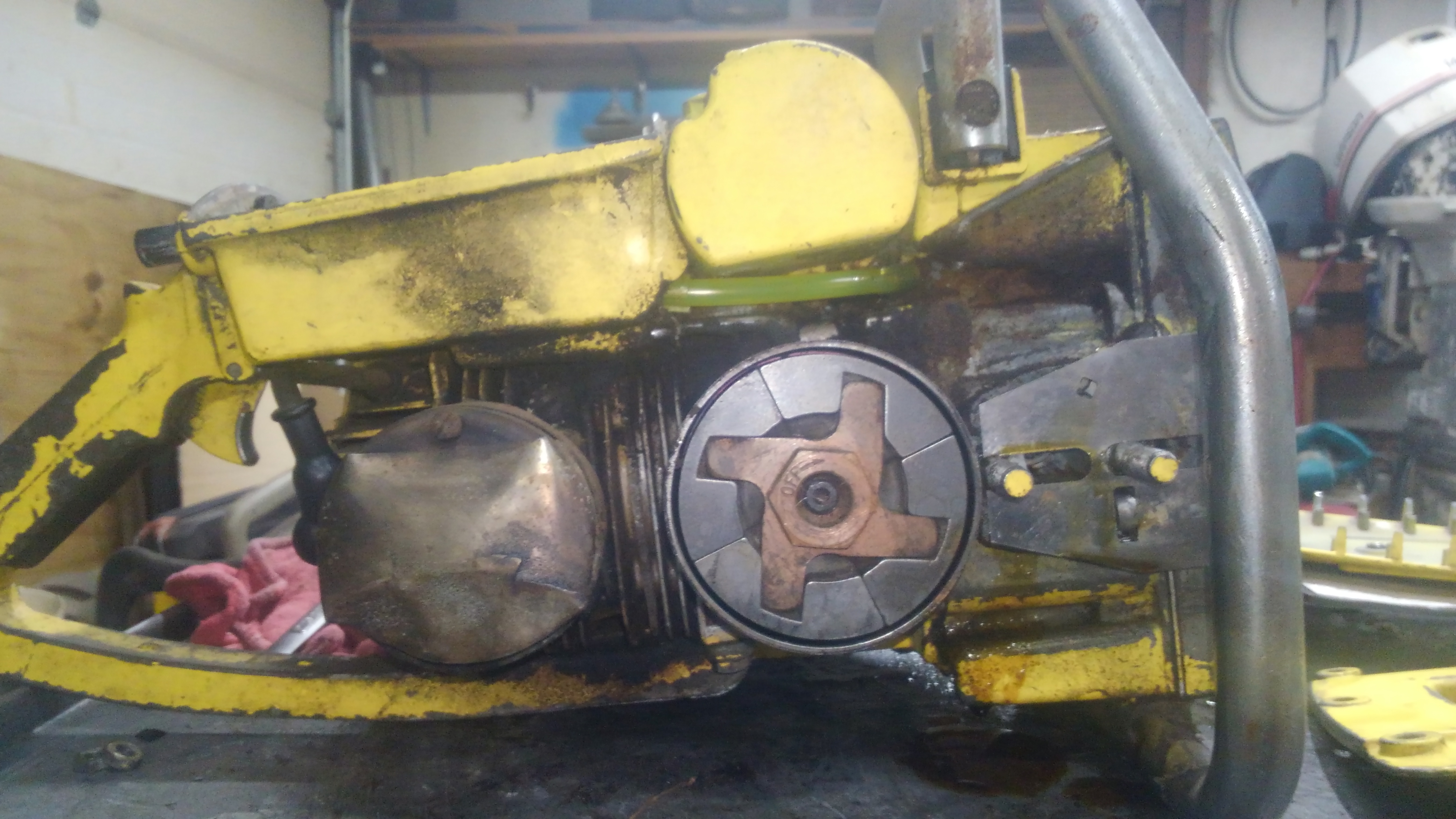

WillG
3:09 AM
10686
Oct 10, 2019
1,730
9,060
Norwich CT
The McCulloch 1-50 is ALIVE!! One loud mother!!
Just need to repair the fuel leaks (which I'm hoping will be simple fixes) put a bar and chain on it and get it tuned in some big wood!!
