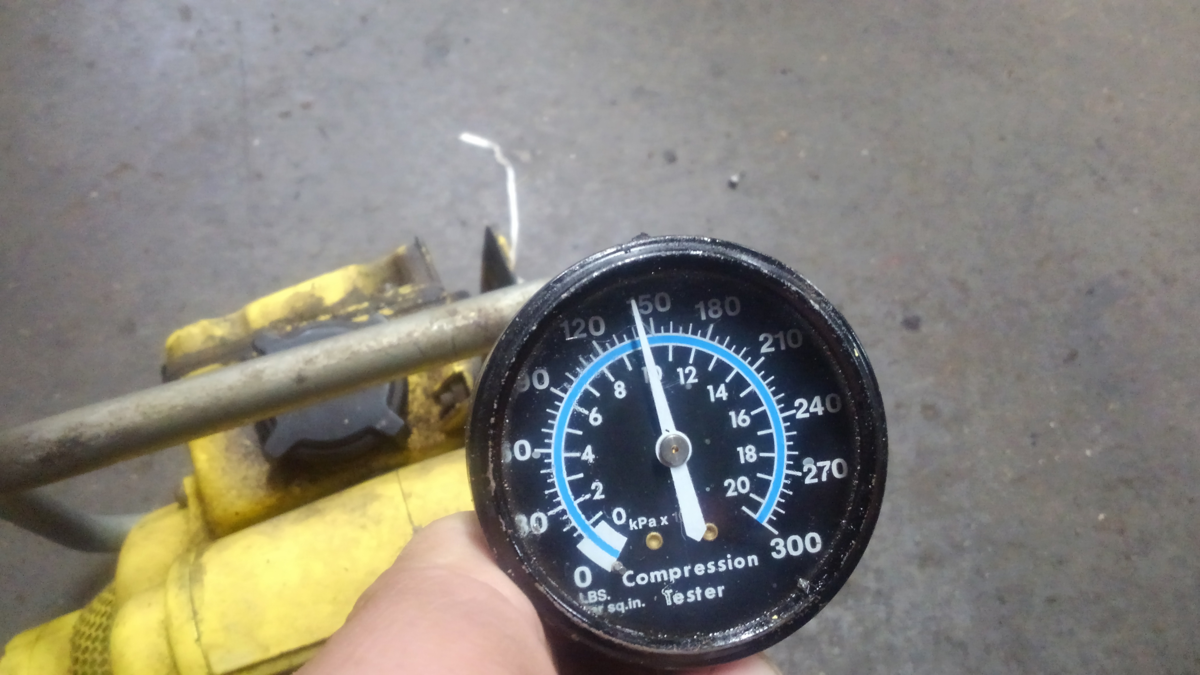

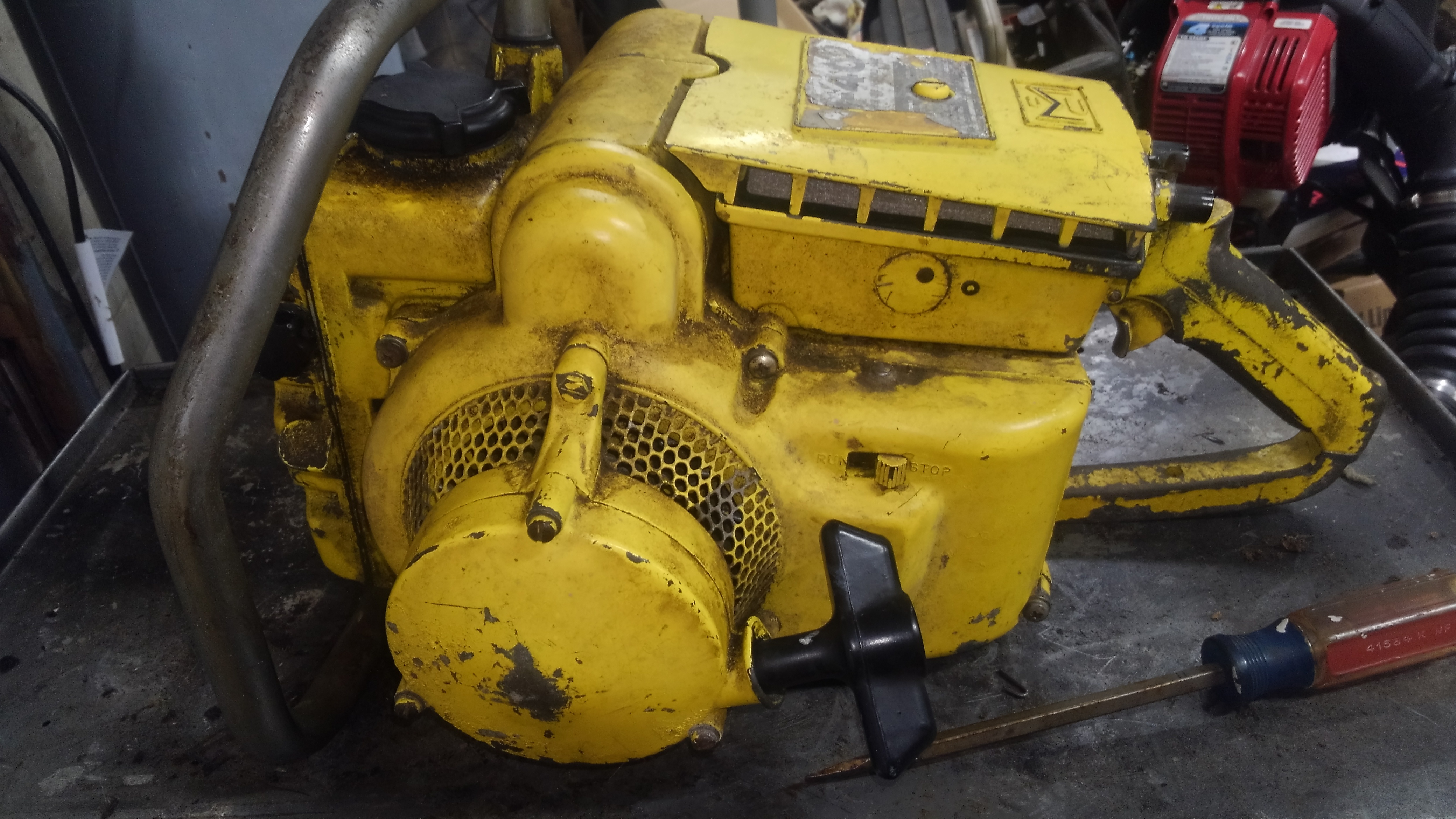

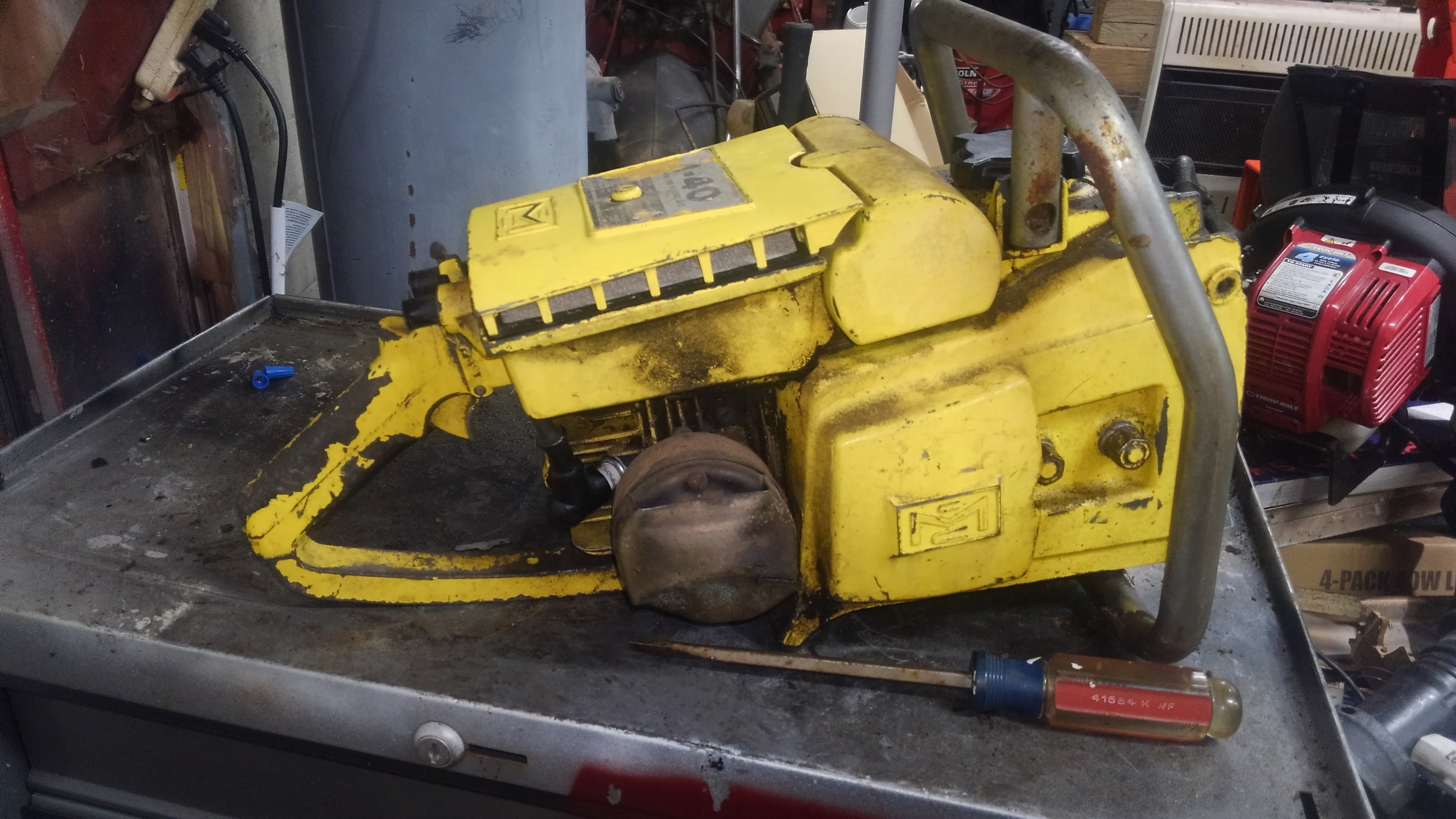

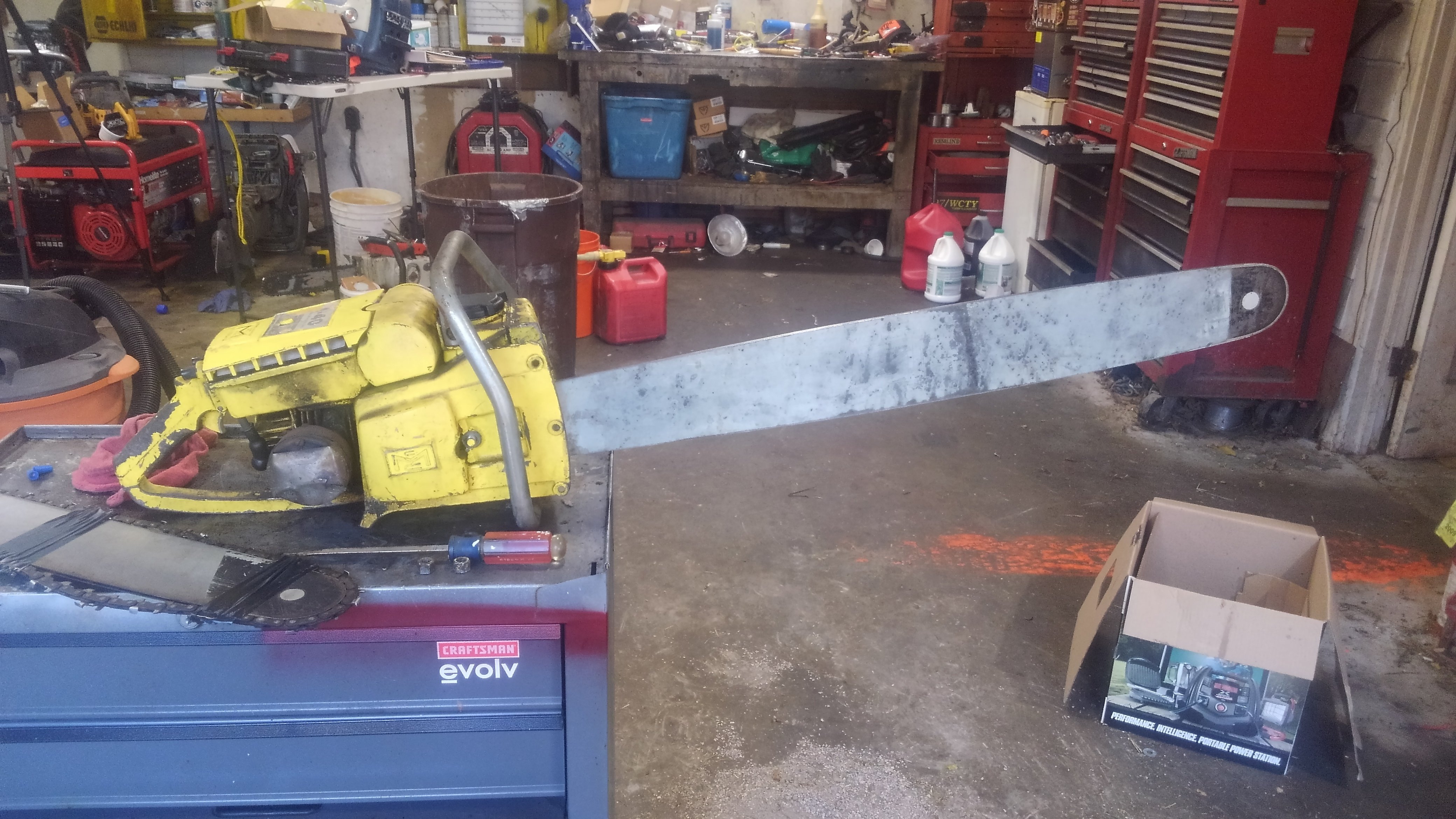

Working on bringing this 1-50 back to life, picked up for $5 at a swap meet. Had no spark but excellent compression, found dirty and stiff points, freed them up and cleaned them, got to pop on mix down the carb. Just got in a new stock of HL Tillotson carb kits and just got in the mail today 24" and 30" bars with chains, also found the missing air filter and cover on eBay. Should be up and running again next week. Here's a few pics and videos of it.

Pics of the 1-50 are going to be in this reply.
