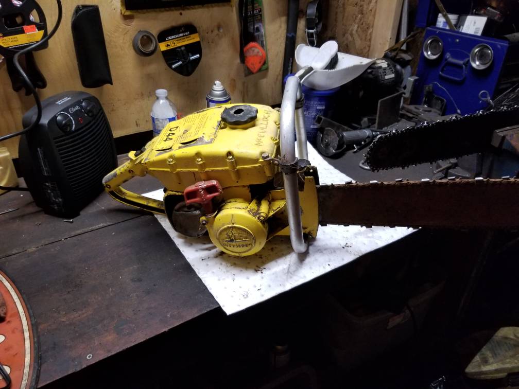

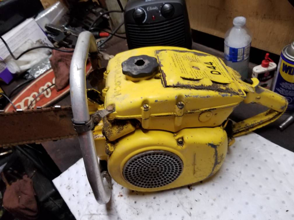

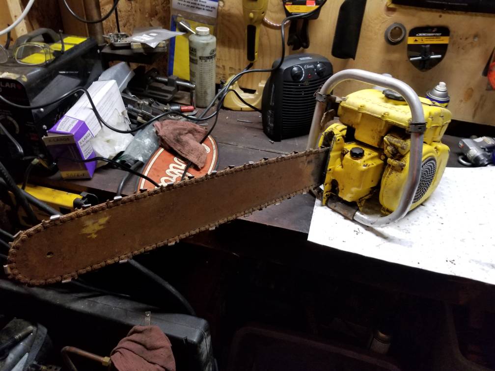

Picked up this old D44 always wanted one with the recoil on oposite side. Just looks neat.
The bad is its locked up. Not sure the cause. Hope its just from sitting. Be a cool saw to get running again.
