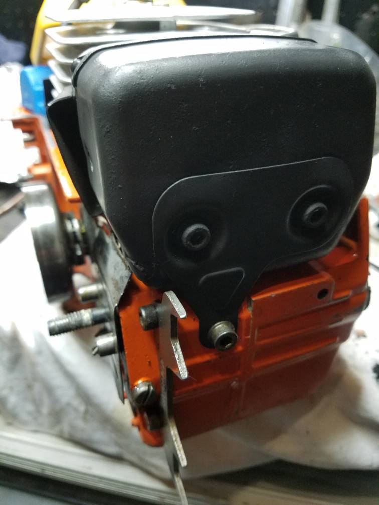

A friend gave this 97 model 242 a few months back, it had thrown a chain sometime in it's life and tore the deflector almost off, kinda tight quarters but got the home made one to fit pretty well.

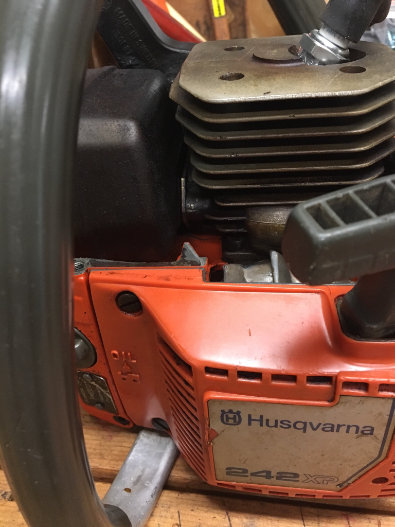

I have a question for you 242 guys... I have a (1993?) 242xp and I'm wondering if it's missing a "heat shield" between the muffler and cylinder? Mine doesn't have one and I'm curious to know if it should..

Not usually ....That looks like you have some of a aluminium shield in between the muffler and the cylinder.

Ok. Yes, there is a metal 'gasket' between the cylinder flange and muffler on mine. My other 2xx series husqvarna saws all have a large "heat shield" that wraps around the flywheel side edge of the cylinder and I didn't know if the 242 was an exception here or not. Thank you

Yup...254 262 i know have the alu shield . 242 should have (uk ones iv seen anyhow) a gasket not a Aluminium plate.

Excellent news. If mine was missing a part like that...my OCD wouldn't allow me to move on until I had found one... and with a 242 that might be difficult! Thank you

42..242xp and 254xp ( 254 should have gasket as well as shield ) all have the same gasket and part number if that helps.

Yep. My 254 has both gasket and shield, and it's nice to know they share at least one part...although 254 parts are becoming harder to find as well.
They only had heat shield on 242/246 Cat muffler
This one is from a 242 xpg Cat year 95 week 11.
