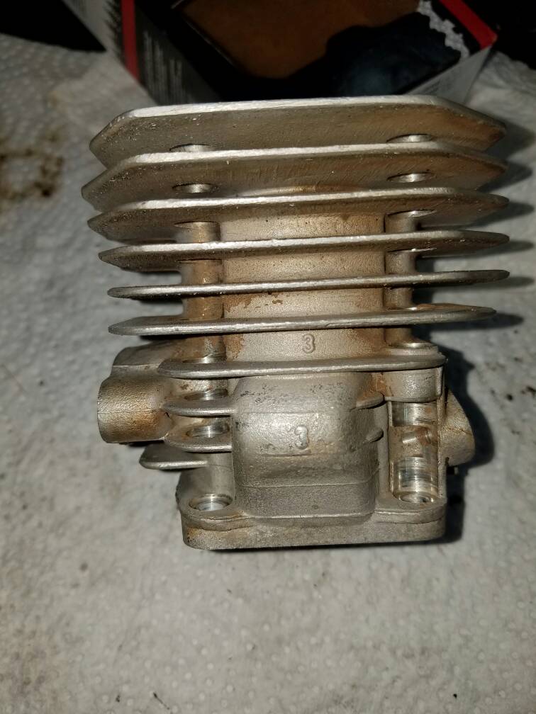

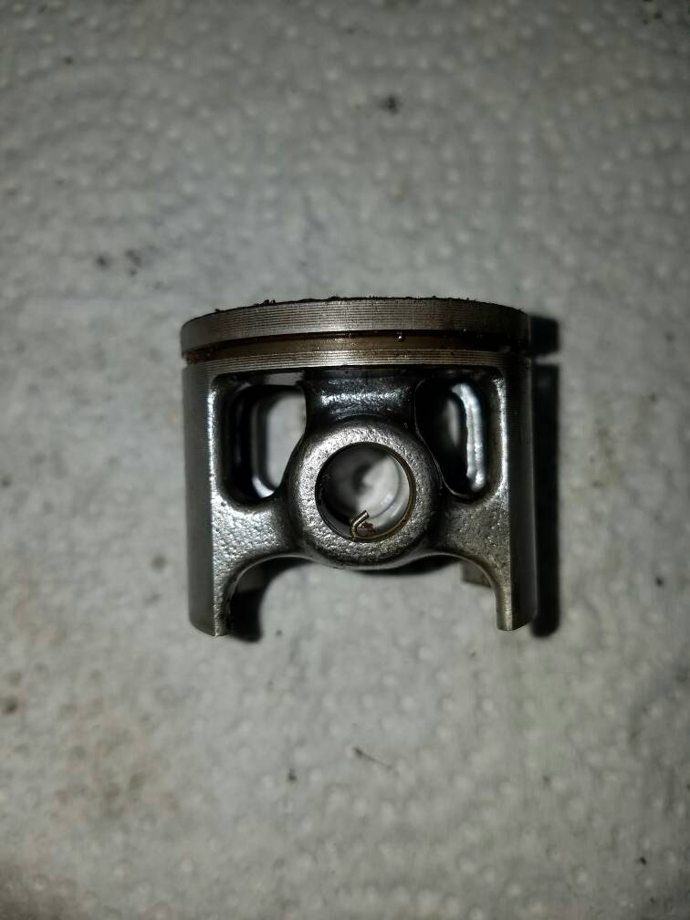

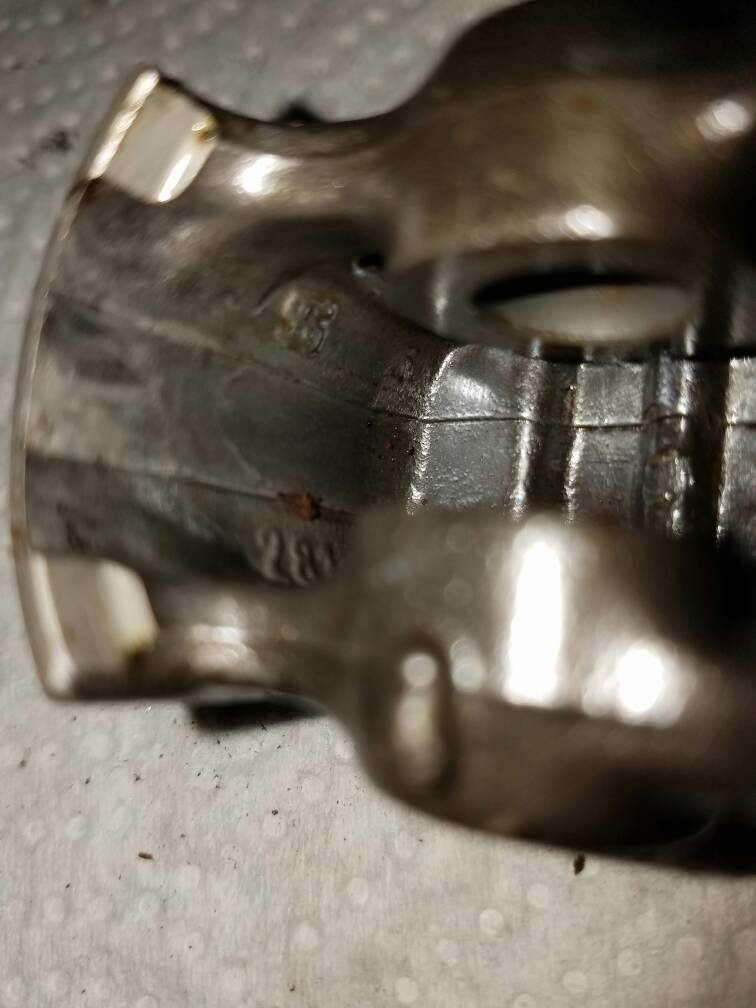

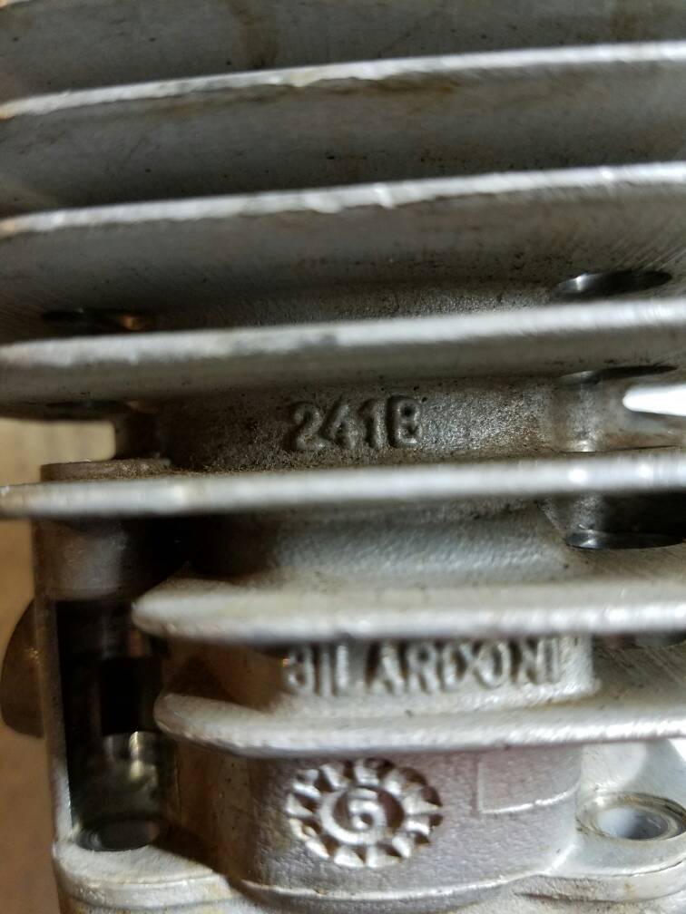

Tor here is one of the 241B cyls, it's on a 97 model 242xp.

that make sense.
KS also made the piston for 42 Special, used in Gilardoni 241A jug
customer saw or did you sell it Simon?
I had it as my own saw for a while...found it when you stood a chance of finding one ! The saw had the best low end as well as top than any other . I find the Gilardoni cylinders on the 42 specials seem to be the strong ones to. It is sold on now :(...I made a mistake with the power of "Hind sight "
