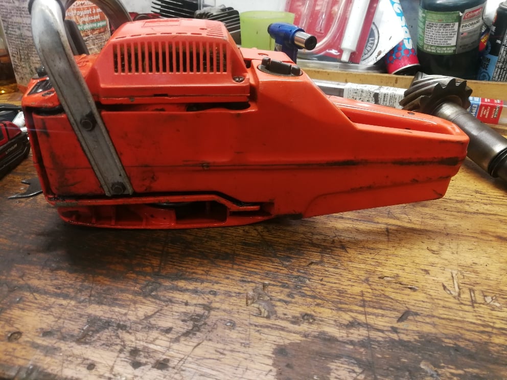

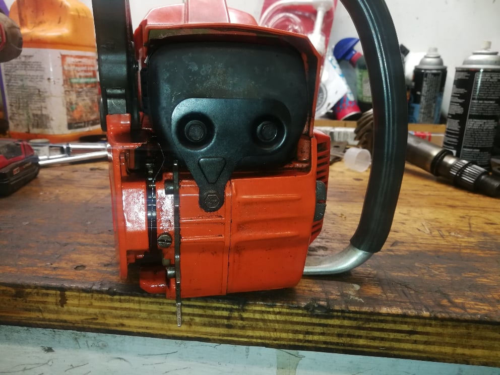

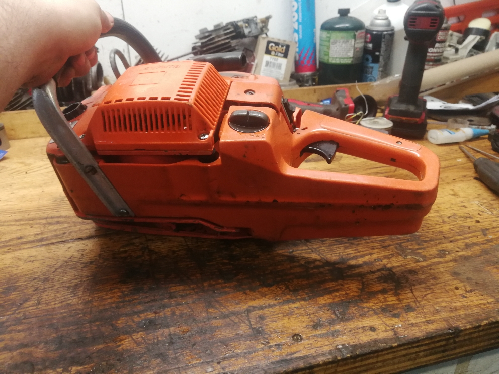

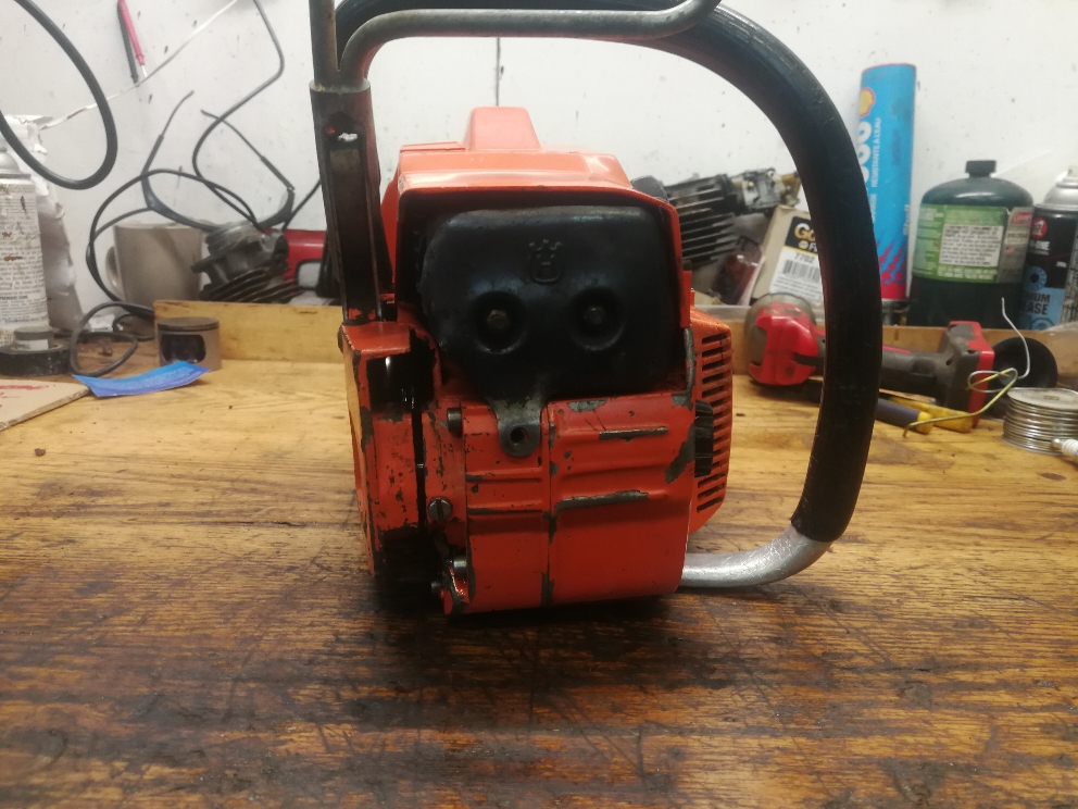

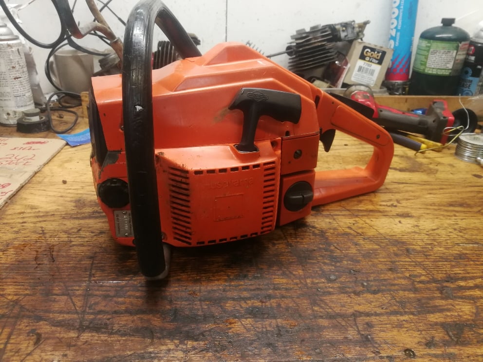

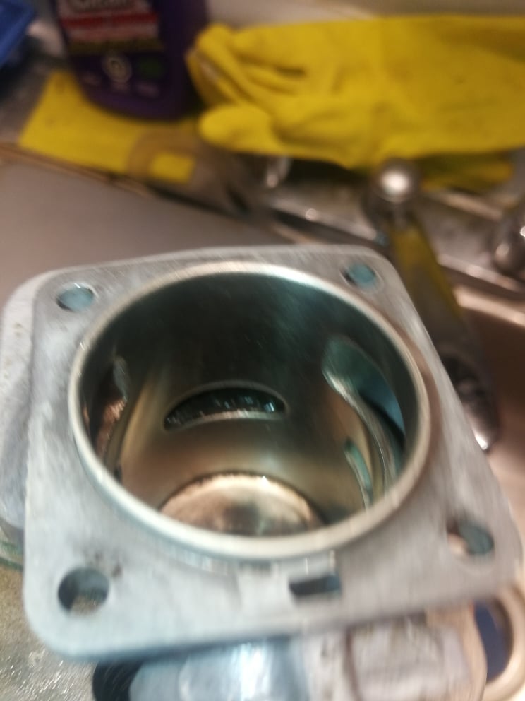

A few more pictures now that it's home on my bench. Gillardoni quad transfer open port cylinder.
Looks like it spent more of its life on a shelf/in a truck than actually doing anything.
Dad had one decaled like this one, and a slightly later one with the special script on the recoil that did have a closed port cylinder. The fellow who dad gave most of his collection is pretty sure he still has it, but I haven't been able to meet up with him while I have been on vacation in the 2 years since dad passed(3000km away so it isn't just a quick trip.)

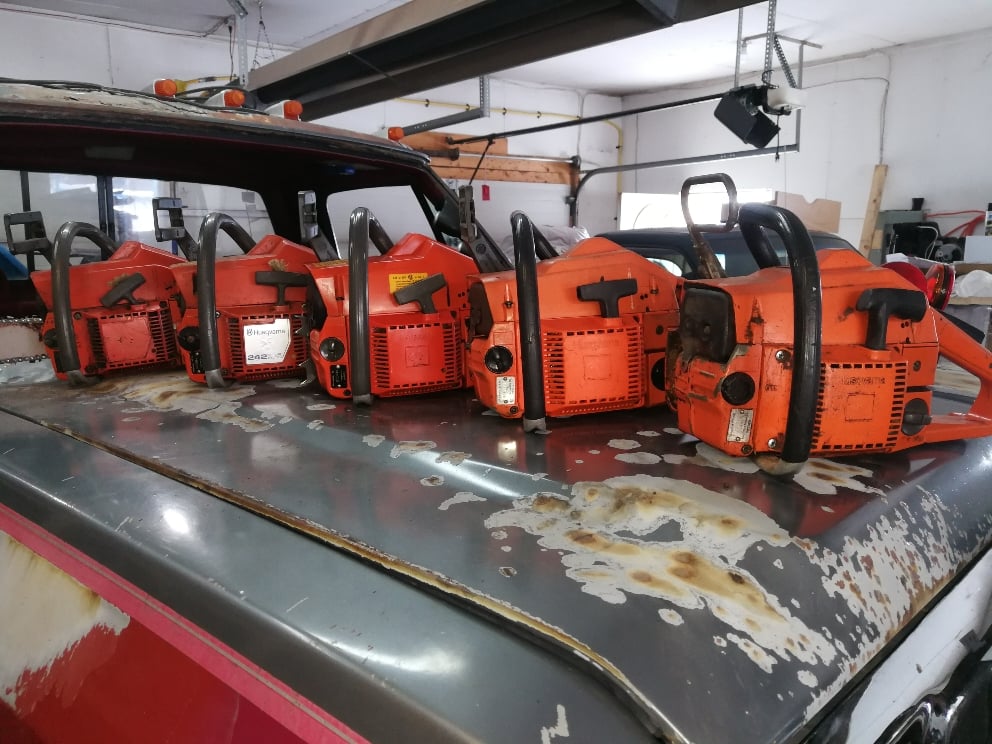

Got a very nicely packaged 238sg today. Thank you very much Ajschainsaws.
Almost have them all now. I really need to give that poor 234 a bath....
That’s a lovely lineup happy it arrived safely
I didn’t tell you at the time but I swapped out the chain cover out
When I was looking for a cover for my newest 42 I actually came across
Three , and I put a better one on the 238

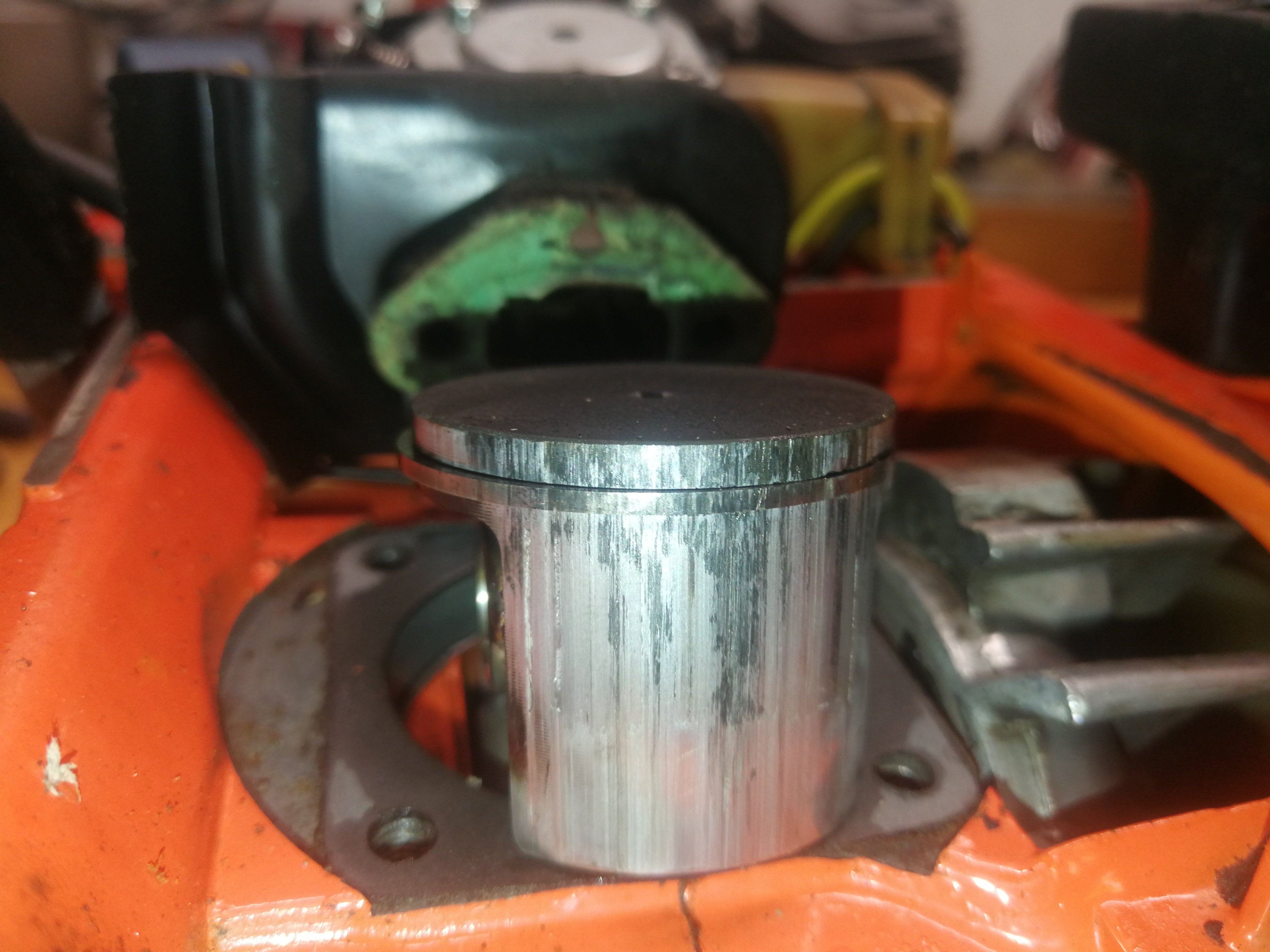

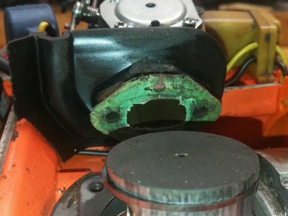

Compression wasn't too bad, around 145, put in a carb kit and got it to run but it wasn't too happy about idling.
Definitely needs the flywheel side crank seal, tore it down and I'm glad I did. Don't have a before of the cylinder, but it cleaned up nice.
Looks like someone made their own intake gasket and it didn't exactly seal...
The piston isn't exactly pretty, but it will run, looks like a Caber ring is readily available so I will get one ordered.
I have read that a 338xpt piston will interchange with some work so I may give that a try.
Not sure if the front handle has been changed for a non heated one or the wiring broke off under the wrap. But the handle elements test good, and the generator ohms out ok, but I didn't check it for output before I tore the saw down.
All in all, hard to say with it having an obvious vacuum leak and needing 2+ turns on the L to even think about idling, but mid-high rpms it feels snappier than the 242.

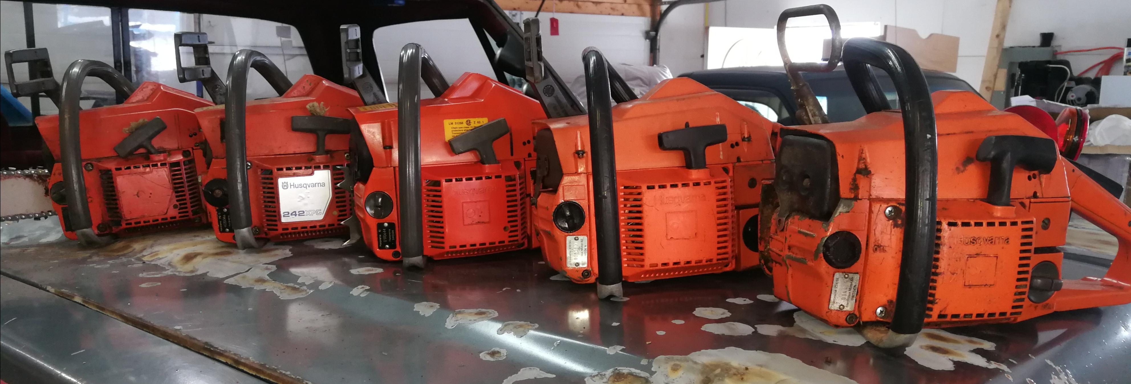

Since I was in the shop anyway last night, I tore down the 234se and gave it what was most likely its first bath since 83:
It's no shelf queen but outside of being rough at the edges, it shows the signs of being a low time saw internally, and runs quite nicely.

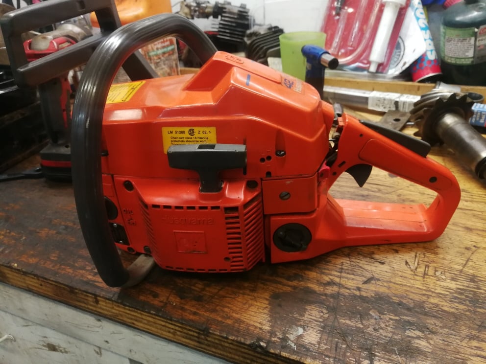

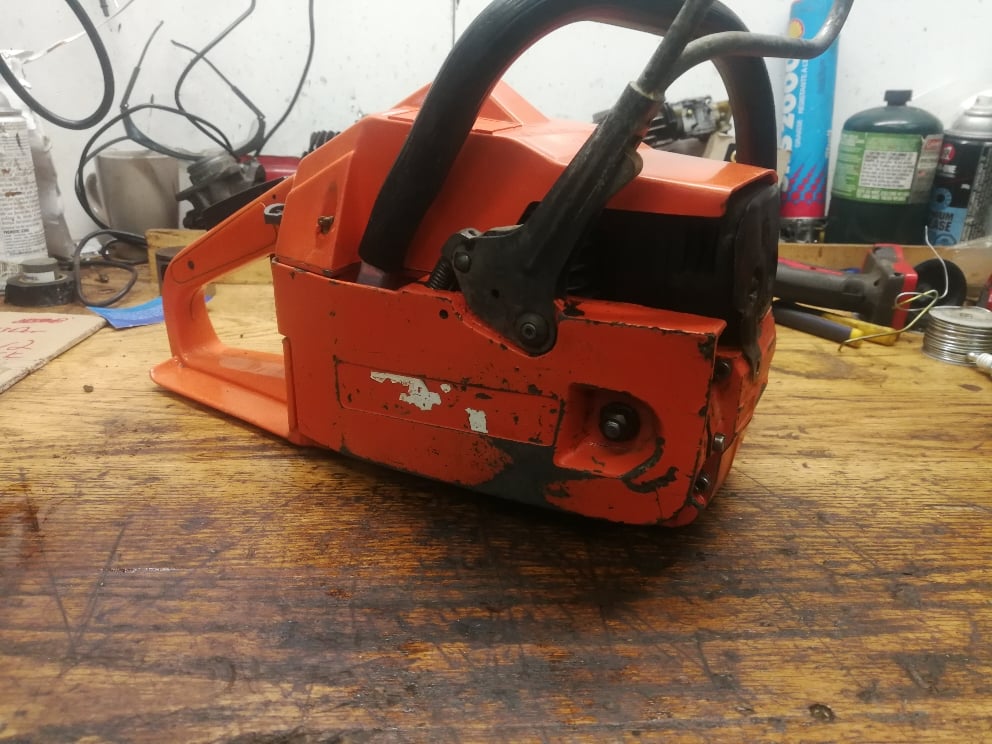

I got these in a pile of saws I acquired a couple weeks ago. The 246 is really nice but needs a top end. The anniversary 242 is complete but dirty, and the other 242 is missing the intake and exhaust and is pretty weathered but not beat up.
good score it’s great news when you can pull some gems out of a haul of saws
