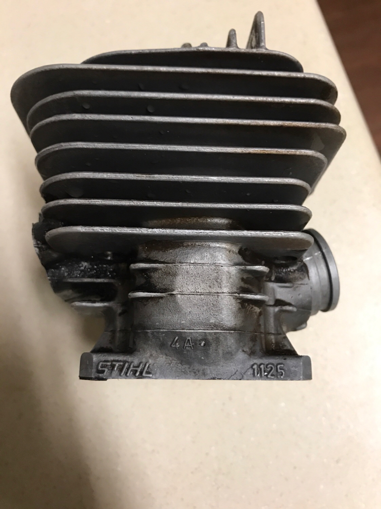

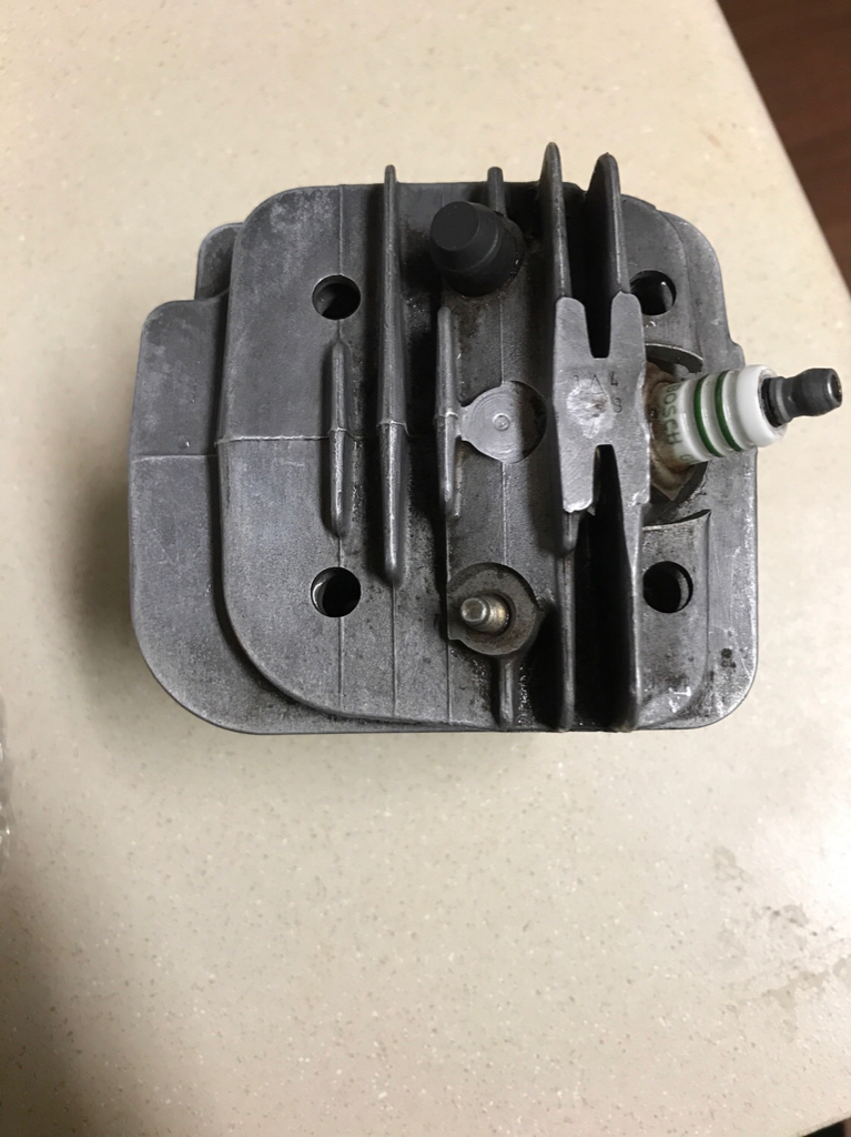

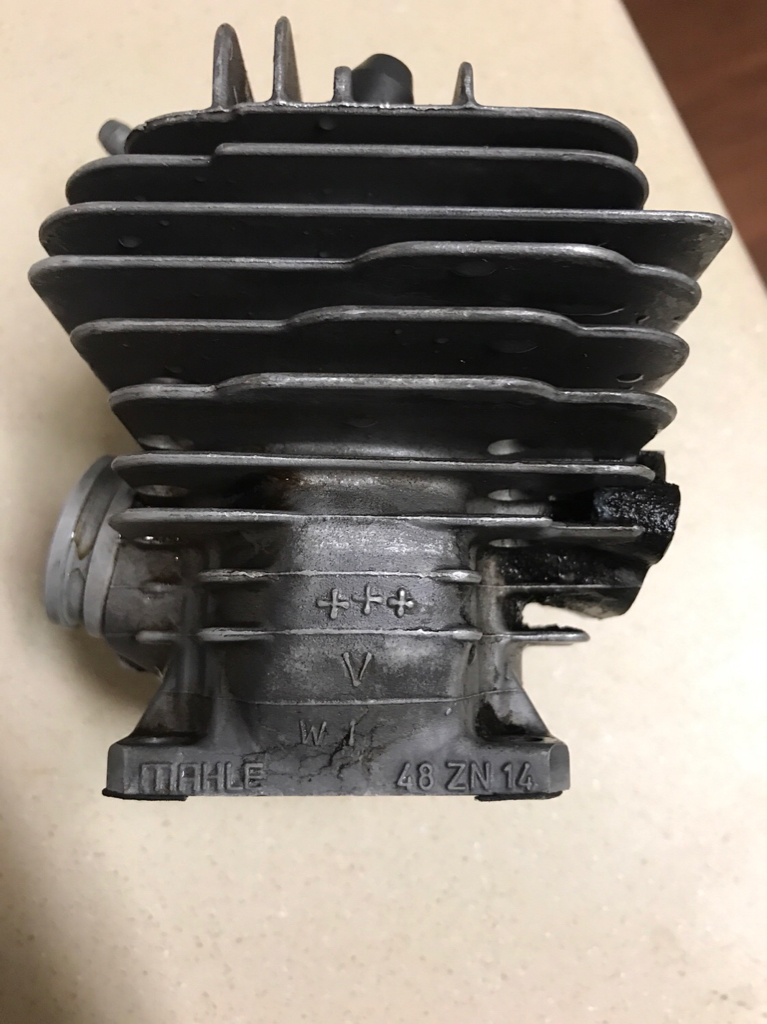

I guess this is just a plane Jane non decomp 036 cylinder as mentioned earlier in this thread, has the dimple in top. What was odd about the saw is that it has the plastic wrap handle, newer style starter, and was made in USA but has the non-decomp cylinder, tall tank vent, non-compensating carburetor, old style air filter. Also a 034 air filter cover fits it.

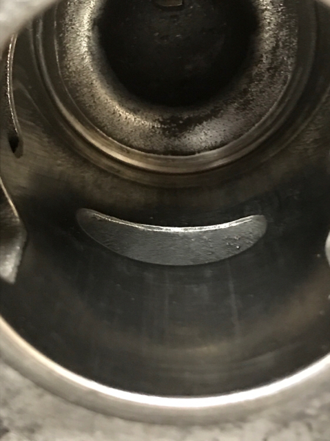

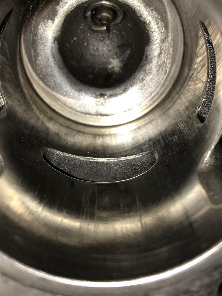

Anyone know what the machined area is for?
