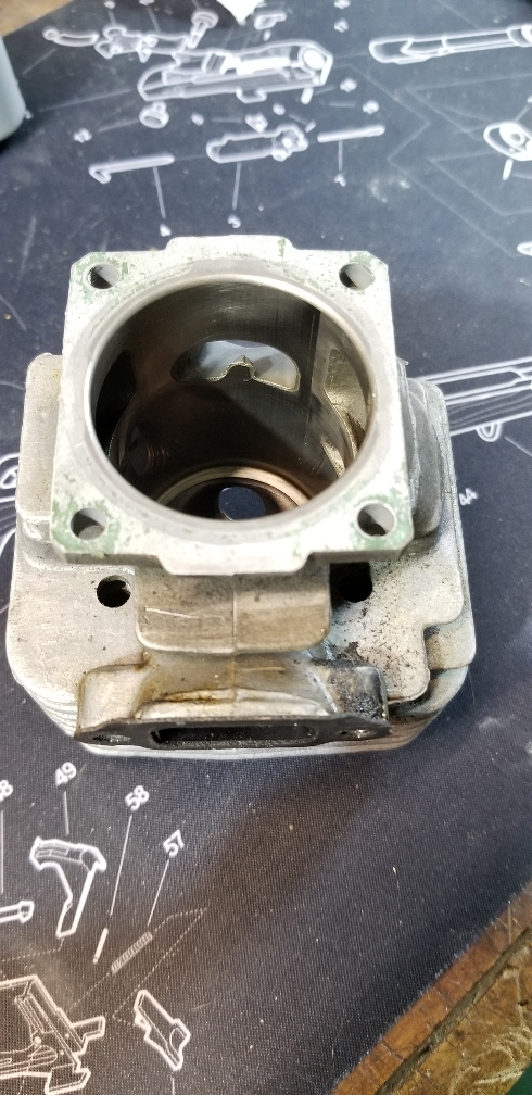

I hope my response to this thread is ok. I need some advice. On the left is a good used mahle cylinder. On the right is a new ks cylinder which one would port or does it matter. Looking for the best performance.

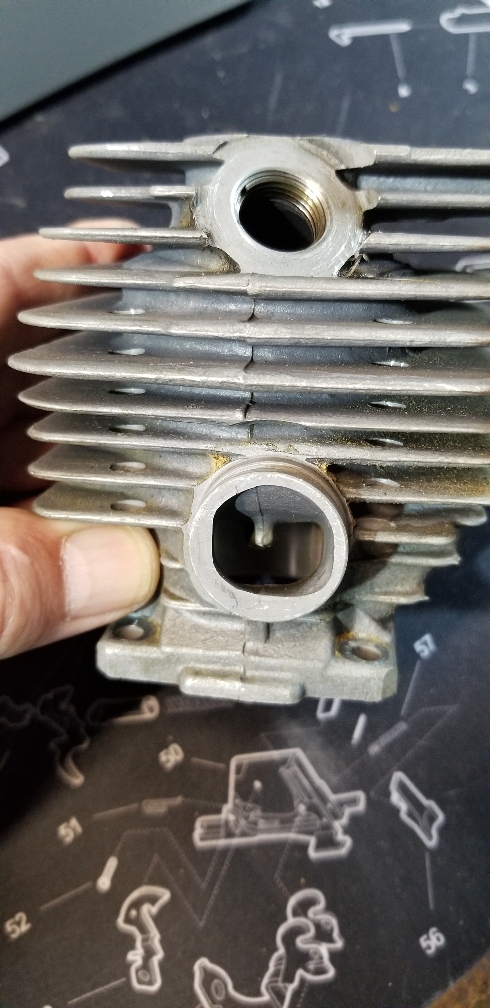

Sorry I may have been inaccurate it's an Ms 360 cylinder. It does have an hole for a compression release.

RI Chevy
8:14 PM
1254
May 7, 2016
27,002
67,802
earth
Looks like a Gillardoni jug...
Based on the color of it.

I'm really new to porting. I have fixed a lot of saws but want to try my hand at some basic porting. Just wanted a suggestion which cylinder might give the best performance ( mahle or ks) or doesn't matter. Thanks to everyone for any response.

I have no idea, both brands have VG reputations. I guess it would depend partially on what equipment you have.
If you are just a "hack" like me, and don't have a metal lathe, I would put a timing wheel on the saw and check the port timing and squish of each cylinder and see what seems to be the closest to where you want to go. It is always easier if you have to do less work to get there!
Doc Al is the MAN on these things, my MOFO 360 runs real nice, and I like having a decomp on it.
If you're new enough to porting that this is your first attempt, I'd not use the brand new expensive stihl cylinder.
Just sayin'..., lol...
Or what MustangMike said about figuring out which one has the best numbers to begin with is good advice.
Width of the squish band/size of combustion chamber/squish clearance could be deciding factors also, more so if not doing machine work.
