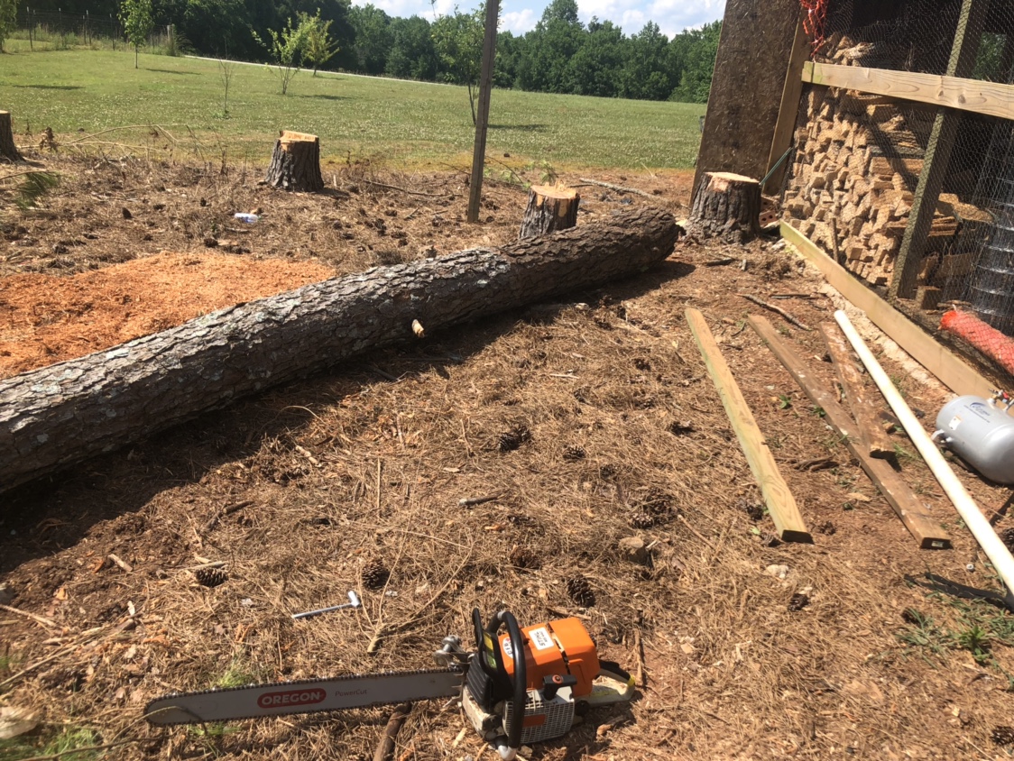

Today a mild to me, ported jug I did real quick last month or so ago, 046 non D is coming around a bit. Did not hone it just ported and finished by hand for a smooth transition at the jug wall. Both rings. It will take 20-30 tanks to seat up. The jug had nice plating, it was on straight and had very nice transfer exits. These transfers are still not flat, no machine work, base gasket delete, no ignition advance, stock carb, port widened to within 3mm on an OEM slug. Lots of intake work but only using about 78* there. It wants more after tank six running a 7pin 28" 050 RS with an HO pump. Muffler is OEM gutted, dual port now and big holes with no screens. It will pull a thirty two with more intake. Chain is grrrrabby off this fresh roll, yeah! Picked, flopped and chopped up a sugar maple about 36 dbh, hard mfer to.
The new piston was a beauty, no toucheded it. It sounds pent up a bit now. Did not raise the exhaust, yet. Saw is out of carb at 2 turns, needs more or a bigger jet and fiddle with the lever height.

It was doing ok for very little work inside. He wants it to last forever :rolleyes:
I don't care if mine wears out rings. I should go to the 272 slug. May be a 9pin saw ;)
Don't wait till you built right up to the tree :confused:
