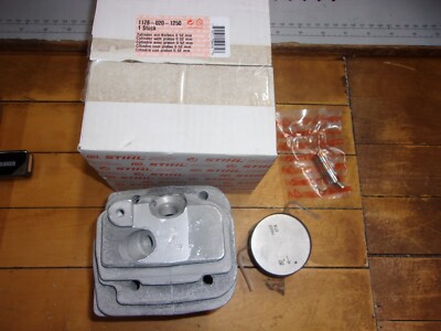

Here’s one on eBay.

Here’s one on eBay.
I sent an email to my dealer to see what Stihl sells them for.
Well the price itself is fine but when I add postage and customs it becomes less worthwhile.
If I cat get one from a dealer here I'll probably buy that one.
Thanks.
