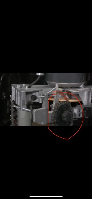

I’m goin to post a pic and circle the part I’m talking about but I didn’t know if you can get diffrent tooth profiles by moving the part that the chain sits in…

I know that’s a 451 I’m just using th photo so you guys can see what I am talking about…
Does it change the tooth profile if you spin that forward or backwards, or does it not change the profile regardless of where that is holding the chain????

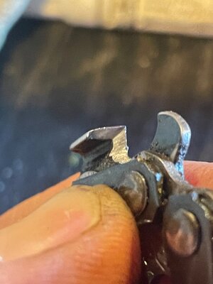

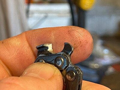

There is a chain I did on square jig, I have plenty room and adjustments to go more/less aggressive…it’s pretty cool honestly… I don’t cut wood for a living. I’ve heated for probably 15 years with an outdoor boiler and I cut wood for my father-in-law so in all reality, this thing would be plenty for me, but we all know how that goes always something “else” lol

Look closely. There are four angles to consider.
Ya I was just curious how much adjustment there was on the 450 on the machine itself…I know you can dress the wheel to get whatever profile you want, I just didn’t know if it had any adjustments on the machine itself
