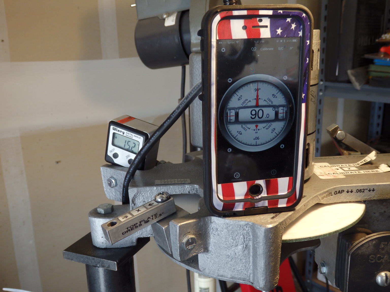

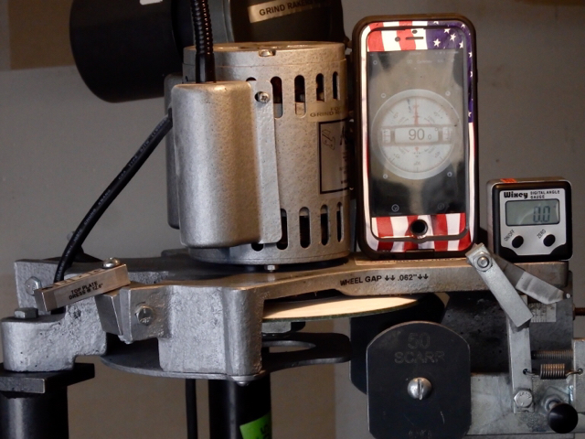

First I would recommend you level your grinder as shown:

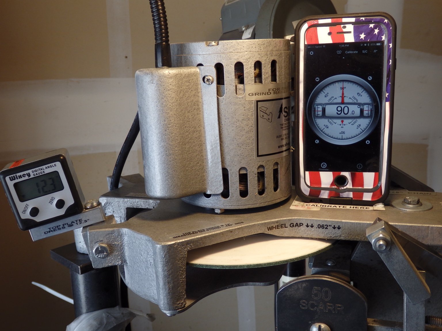

Then remove the diamond dressers and place angle finder on the top plate diamond dresser swivel as shown below- (approx 12 degrees):
Finally repeat the same procedure for the sideplate dresser as shown below:(approximately 15 degrees)
Now just reinstall your diamond dressers. Dress the stone and try sharpening a cutter.
