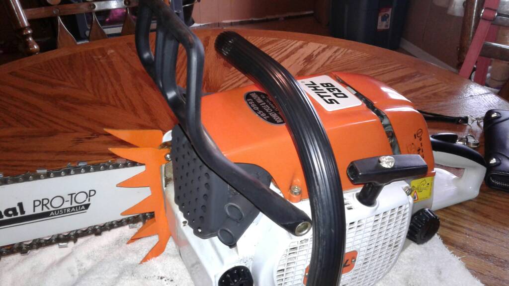

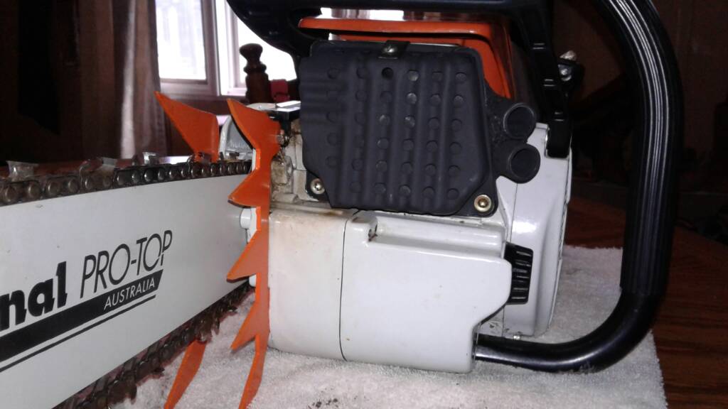

Well here it is. It dryed quick when its 85 in house lol.
Im pretty happy

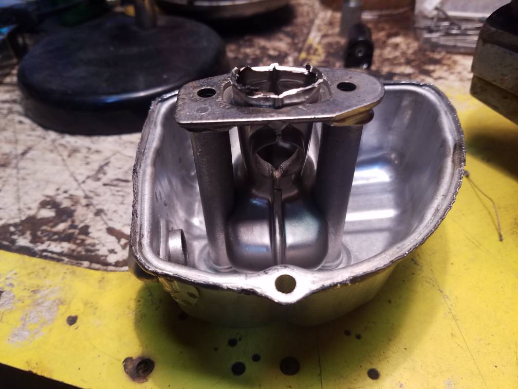

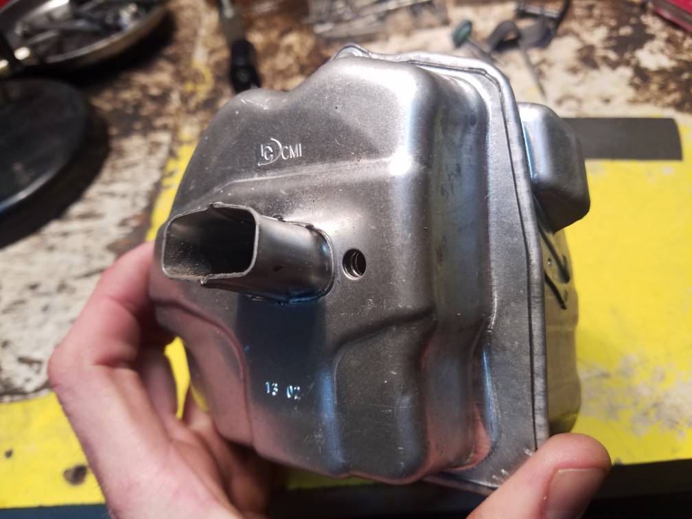

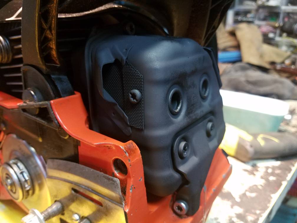

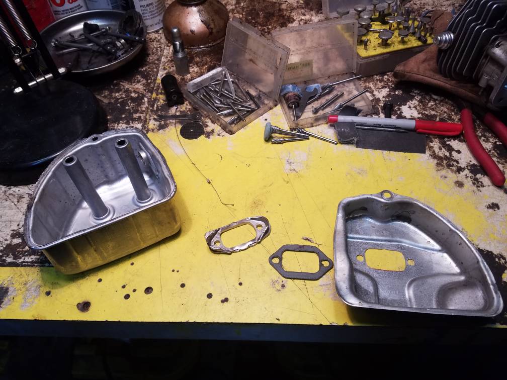

Humble mod, works nicely for me and my PS-7900.
BEFORE
Uncrimp cold with side cutter pliers (works nicely, left crimp at an angle under 90° for easier recrimping)
Enlarge all existing holes and ad a few more (I didn't want to remove the birdcage entirely)
Put together and recrimp.
AFTER

Looks like something that needs to go back to the drawing board!
That doesn't look like a improvement for a PS-64xx/73xx/79xx.
The genius behind this has declared that this “keeps the benefit of the scavenging deal in the muffler”. He has a pretty sweet thread goin on it right now on AS. Same guy had a thread about putting a sparkplug in the decomp hole of a saw....
