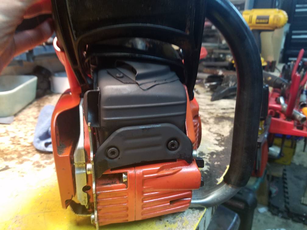

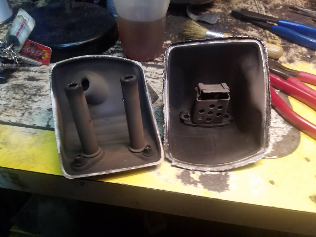

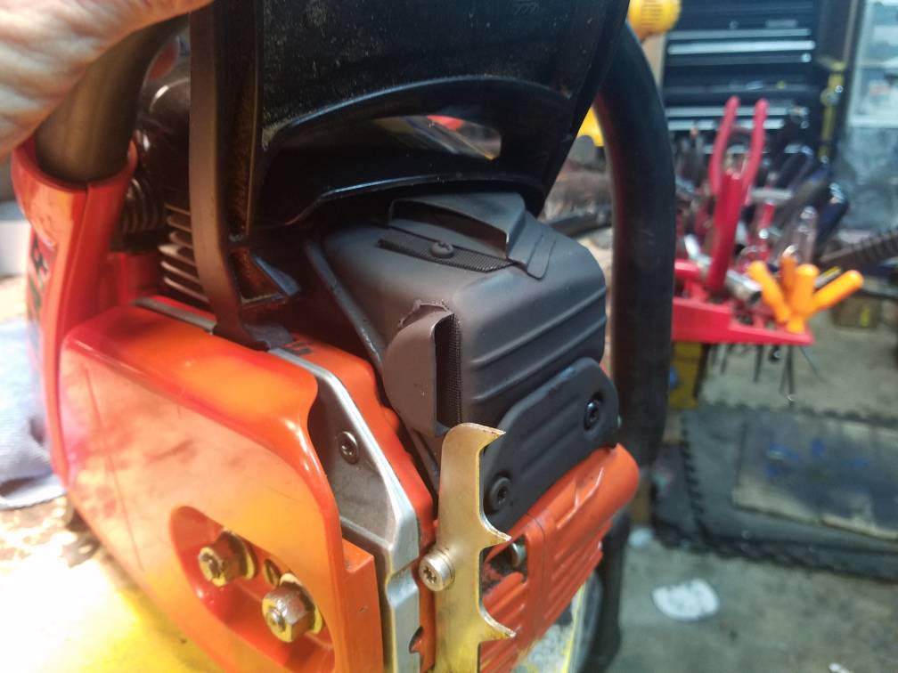

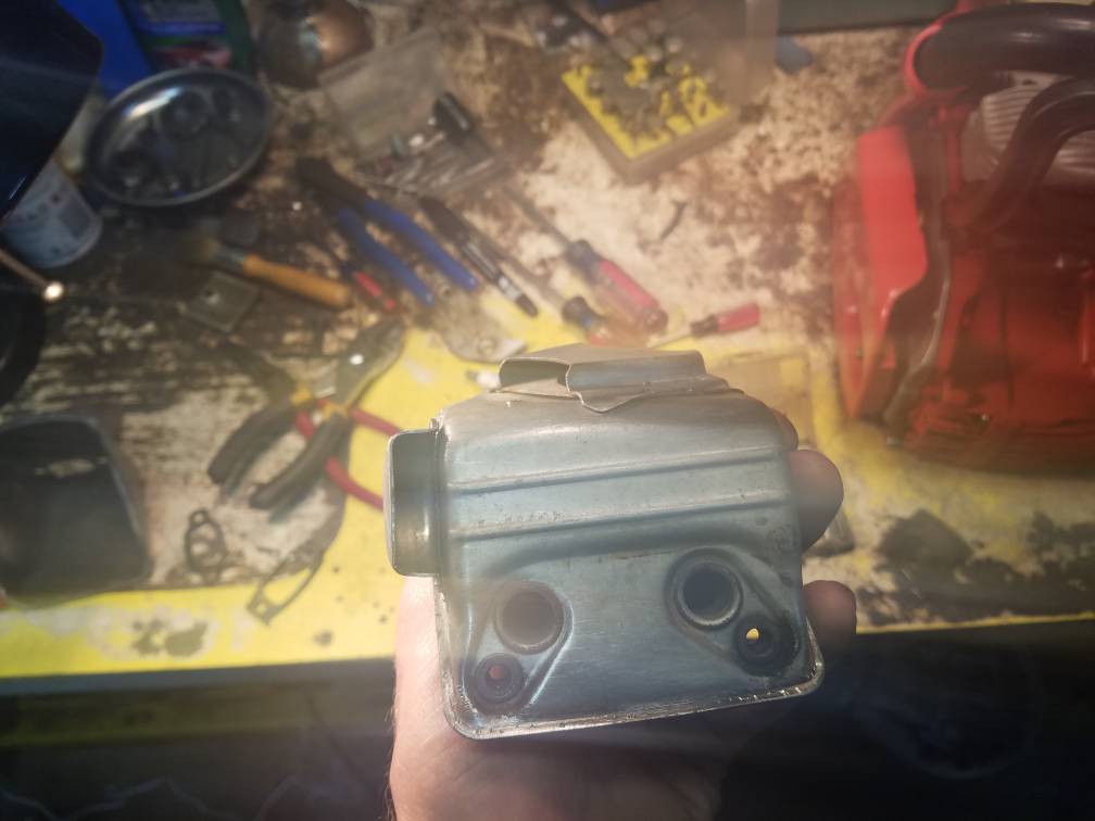

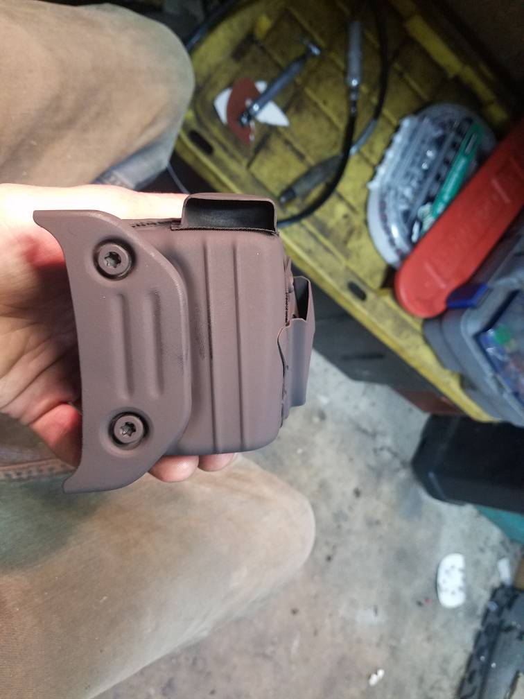

Muffler mod I did on a dolmar 510 i just finished porting. Typical dolmar muffler, pain in the as$. I uncrimped it, split it and took baffle out. Matched ex port to muffler, opened up original port a little and added a second port with deflector. I didnt like the way the exhaust flows out the original port. When it comes out of the saw its angled down slightly then has to go up and back to the back of mufgler and then out the port. Kinda makes a big loop. So I really wanted to get another port in it somewhere. I don't like them going straight out the front and prefer them on the sides. Took me a little while to make somethin up to fit but I like the way it turned out. Can't wait to see how it runs now. ( wow thst turned into a novel. Lol ) [emoji42][emoji42]

Really nice job. I am curious to see if that Aluminum muffler heats up more than the stamped steel. Would a piece of aluminum heat up so much that it melts anything? I am not up on my metallurgy.
I love the huge outlet.
Looks sexy.
Seems like it would dissipate heat better than steel? I think some versions of the 880 have a cast aluminum muffler.
