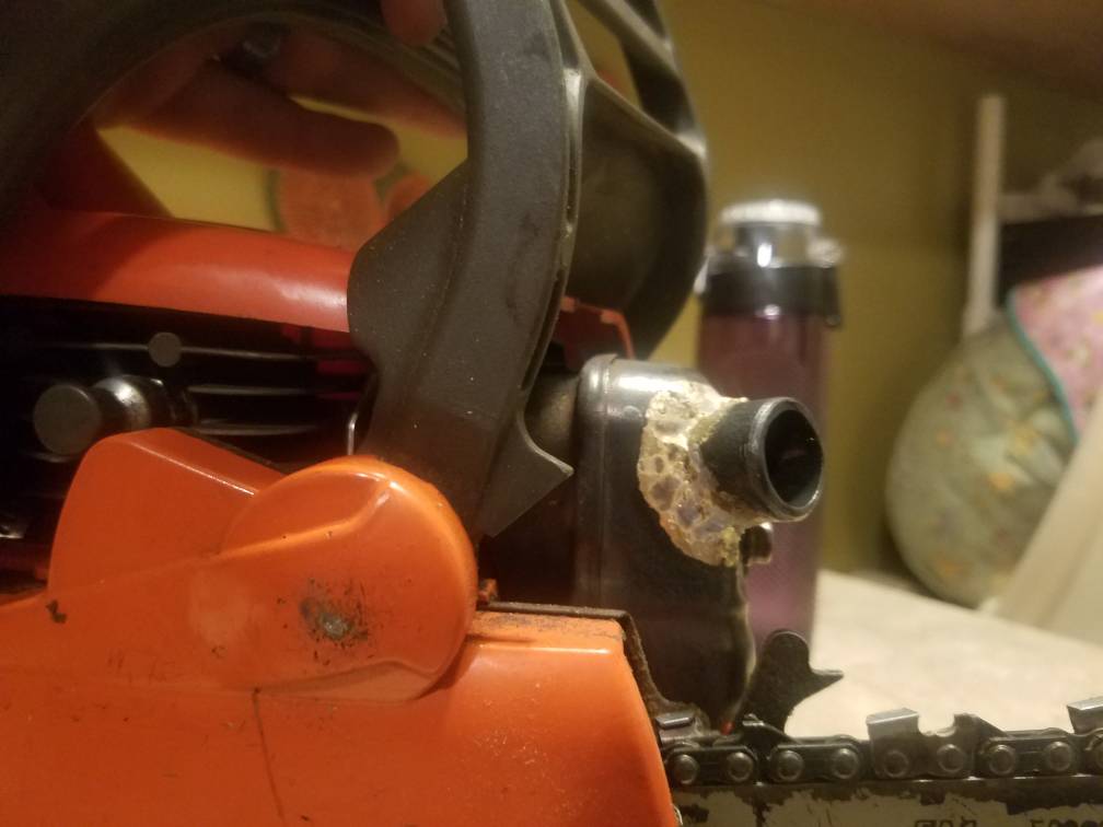

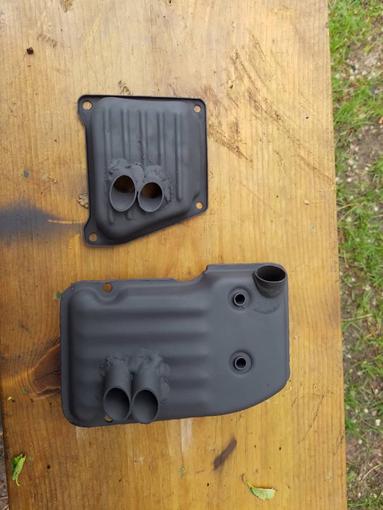

This mm was NOT done by me, it was done by @Mastermind on the saw he ported for me. The picture does not do it justice, the attachment of the pipe to the can is absolutely flawless. More like art than something that is going to be used, but used it will be. Ain't no doubt about it, the guy is just good at what he does and sets the bar pretty darn high.

Looks good Kevin. Did you have to cut the plastic at all to fit the deflector?
What is that piece the bottom of the saw in the photo?
The west coast kit has that "skid plate" to protect the cases. Early 394's don't have provisions for the skid plate, though you can drill the holes and tap.
The vertical plastic was already cut out for some reason, so I asked Sondre if he wanted to take advantage of the cutout.
I ended up trimming the top of the plastic at an angle to clear the top corner of the AM muffler and deflector
That piece is from Husqvarna, IIRC they call it a protective plate on wrap handle models. It helps keep the lopsided brick standing level, even if there aint no wrap handle

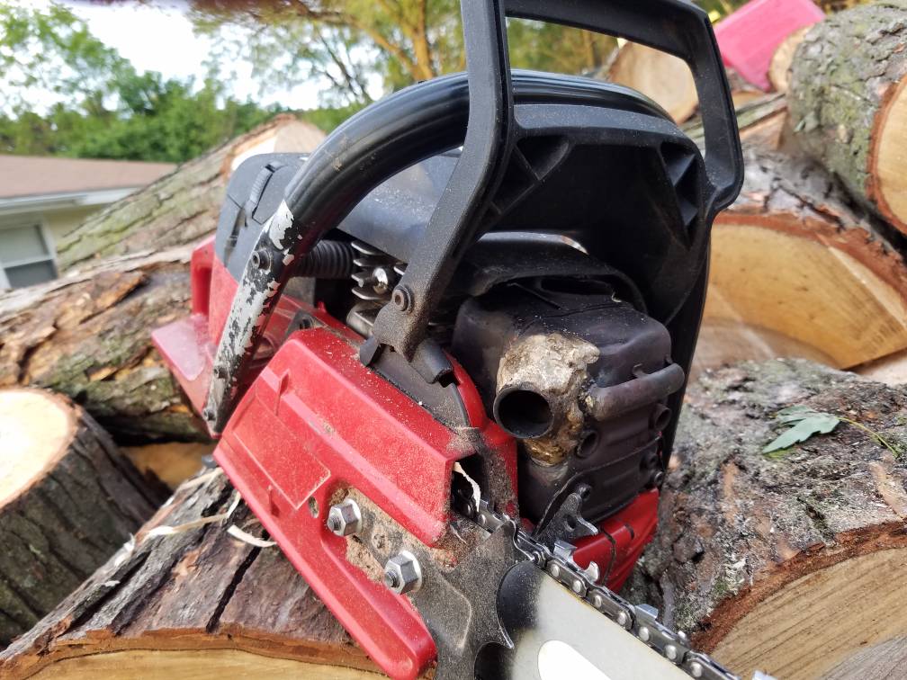

Thanks! I brazed then sanded the pipes on my belt sander to achieve the look.

Iv been thinkin about doin a muf mod on mine. Thinkin clutch side so i can get tje exhaust away from the clutch cover. Its starting to go brown.
