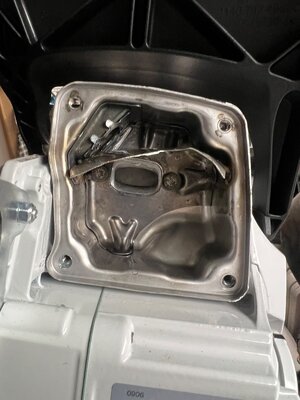

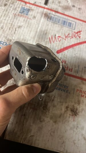

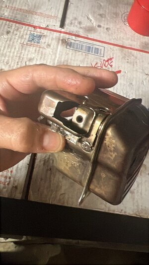

Cut the factory spot welds on a 261c can and opened the outlet. Plan is to drop a piece of metal though a slit in the top to eliminate any short circuiting of the exhaust gasses right out of the deflector.
I have no luck at all welding on the newer Stihl mufflers. I’ve tried as much as I know and still can’t do a decent job. 584AE0AB-5999-41A8-BEFB-0762A612B5DA.jpeg583A3217-6714-46AA-9D62-947F6E456328.jpeg
