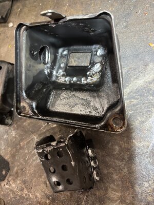

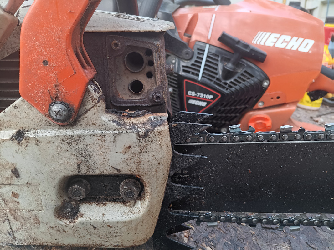

This $220, filthy faded screamer has a muffler that is so rusted, you can't remove the bolts. Stripped out trying.
Gobs of compression. No air leaks. Lots of power, no need to take it apart if she dont want to.
Took a pair of pliers an tore the screen cover off er. Took a 16d spike and hammered few fkn holes. That way there, no metal shavings from drilling.
Echo CS 670. Tunes out right at 13,700 rpms with a smidgen ah no load burble.
