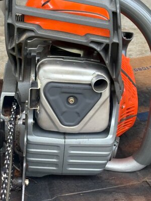

Clutch side view of saw, with muffler mounted. But no bar & chain mounted.
The outlet deflector (right side edge, in picture) seems to have three little tabs on the edge of the opening.
Gotcha. That is the original Husqvarna outlet that I removed and then brazed back on after removing the baffle underneath. I'm not sure why they put those little tabs on there.
That muffler, despite being completely hollow inside, is pretty quiet. I don't know if the tabs do anything.
