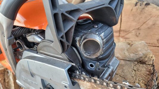

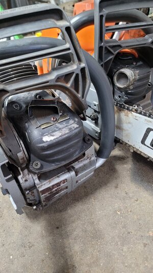

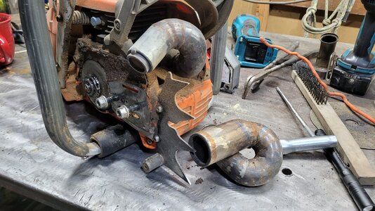

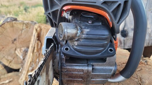

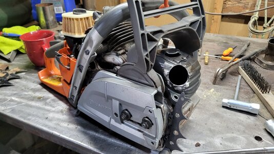

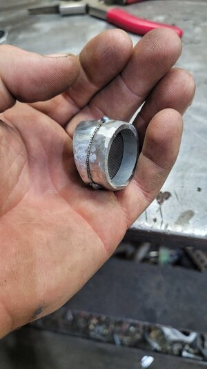

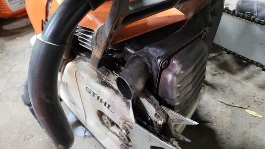

Heres my pipes. The one on my 372 works great. The curly 461 pipe i think works but made the saw super finicky.
The 461 realy likes tge 1" port on the oem muffler. Kinda gave up messing with the.
pipe on it
The 372 is 1" with a 3/4" spark tube insert. That insert might be why it works.
The 461 pipe i have i think 1.25" outlet on 1" pipe. Probly need to go down to 3/4" outlet. Might drastically change how it runs.
