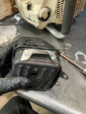

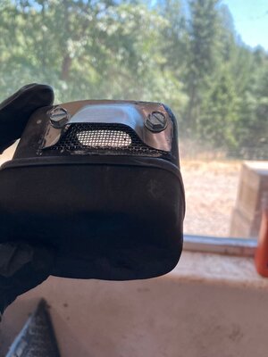

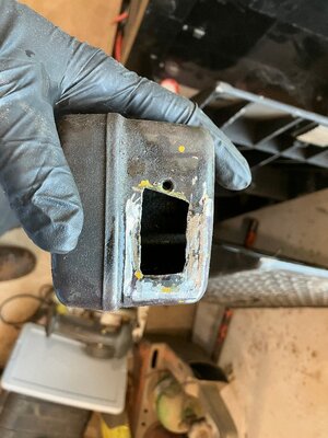

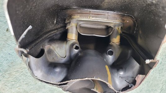

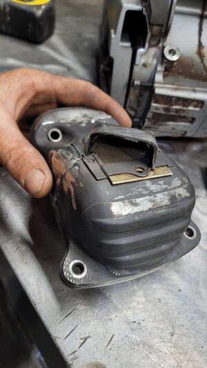

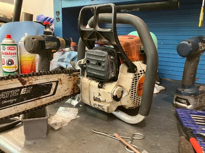

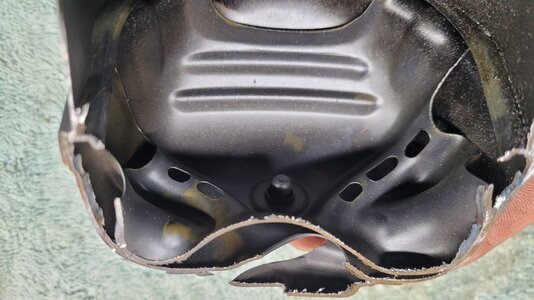

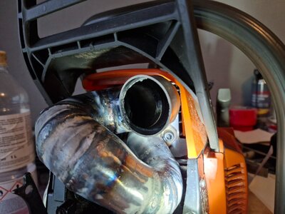

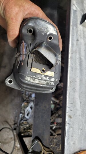

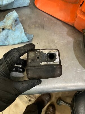

I wanted to update on the exhaust screens question that I brought up.. I spoke to Joe and he said "you can remove the screens, removing them might help maybe 1-3% but nothing major"
I have since tried running the saws both with and without them, and I'd swear that having the screen out effects engine temps on my two smaller saws (especially 550xp) run about 5-10° cooler and sound a little better too.. the 592 seems unaffected regardless of wether screen in or out but that one uses a larger mesh and even more open muffler-box to begin with.
