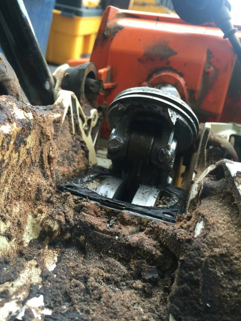

Ring was whole. Broken piston was sanded. You can see the funny sanding patterns

scattered that one this summer. Logger used. Logger abused, was still a great saw up until it grenaded. It had a few million feet on it.
