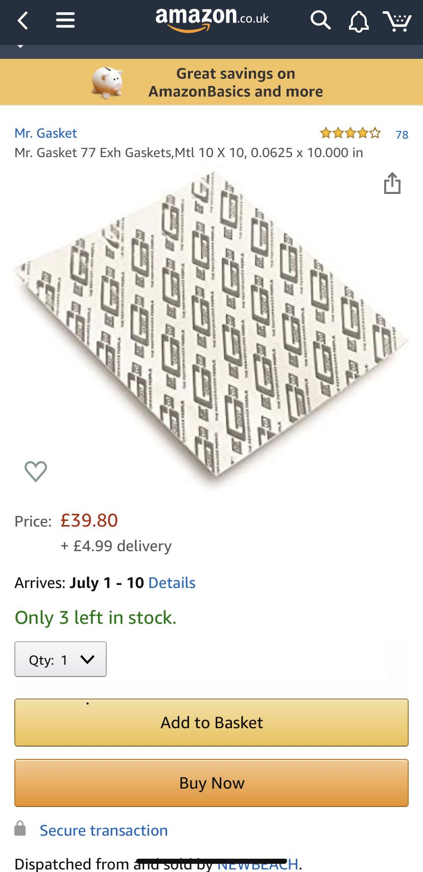

Been looking for similar stuff. Searched amazon, and low and behold, look at the UK price, and this is the cheapest.
