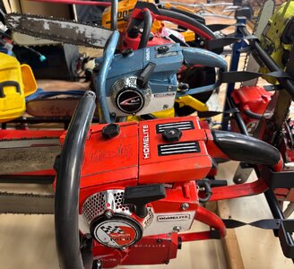

Red color Fuel cap. Has anyone cleaned up and boiled one in a pot of dye?
I'm more of a function over style guy. But I do find some of the clean up and re-coloring jobs pretty interesting from a technical point.
The old computers crowd has some extensive work in getting old plastic to look nice again.
