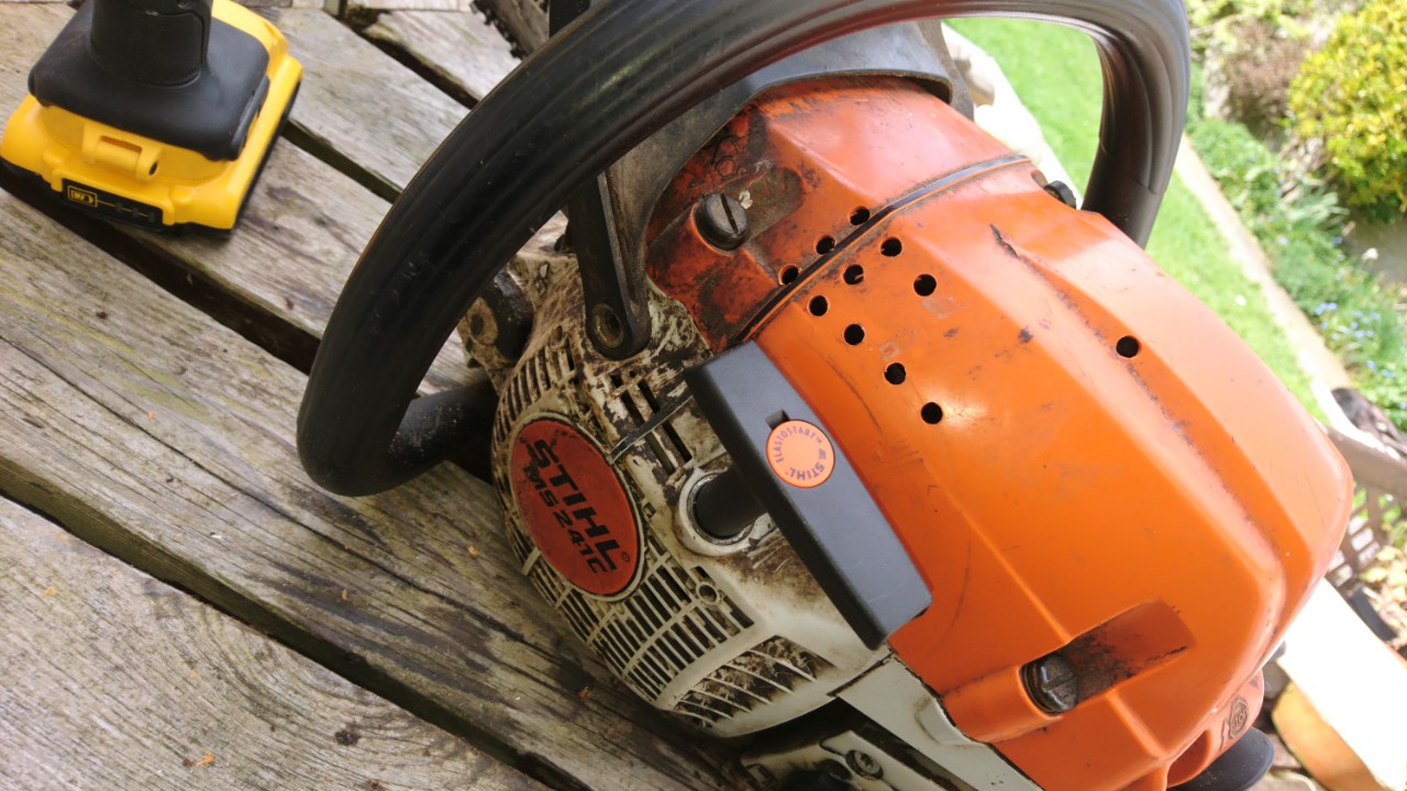

Speaking of heat - I was a bit paranoid since this poor 241 lost it's crown in a forestry accident, and aired out the lid not long ago. Whether it makes any difference, *SHRUG*.
