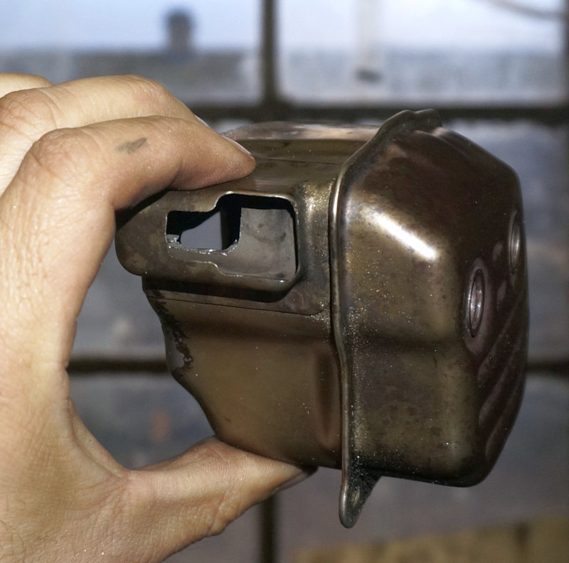

The only place to add a deflector is on the starter side in front of the seam. I use screw pop rivets, trying to weld them is an exercise in frustration. There is no internal baffle to worry about.
Unless they've removed it on a new version of the muffler, there is a shelf that separates the intake side of the muffler from the exit, forcing the exhaust to bounce off the front of the muffler and then back into the exit hole. In other words, a baffle.
Removing this baffle hugely increases the power as well as the noise. And I mean it really increases the dB's. On the ones I do here, you will see at least a 25% improvement in cut times. I have a video showing one that improved cut times by about a 1/3. A good way to tell if your muffler has a baffle is to listen to it. If it isn't loud, it has a baffle. Another way is to remove the muffler and look into it . If you can not see all the way through it, it has a baffle. Here is one with the baffle removed and the exit widened with sunlight shining through.

I like loud saws! The gains you’re seeing have my attention for sure. My 261 moved on, but a have a 241 and guess the muffler construction is similar.
The 241 has a similar exhaust, but much shorter. I haven't seen similar gains, tho. Same with the 362. Something about the 261 makes it different. Perhaps it just has more carb and intake. Dunno.
