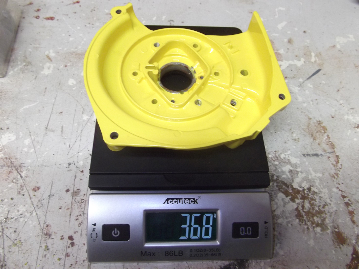

Thanks for sharing the weight difference. What is the name off the yellow Powdercoat used?
That was powdercoated by Mike ( @Glock37 ) - I think it's some sort of safety yellow.

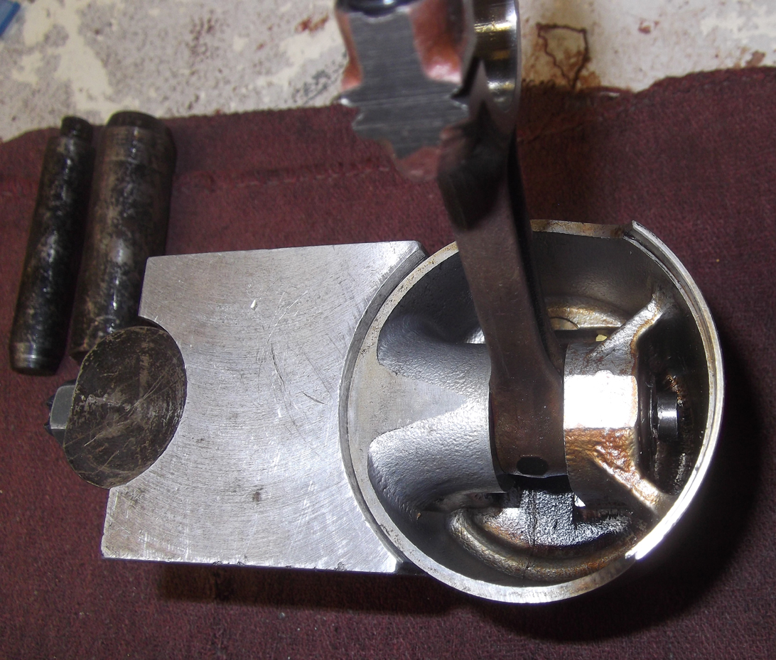

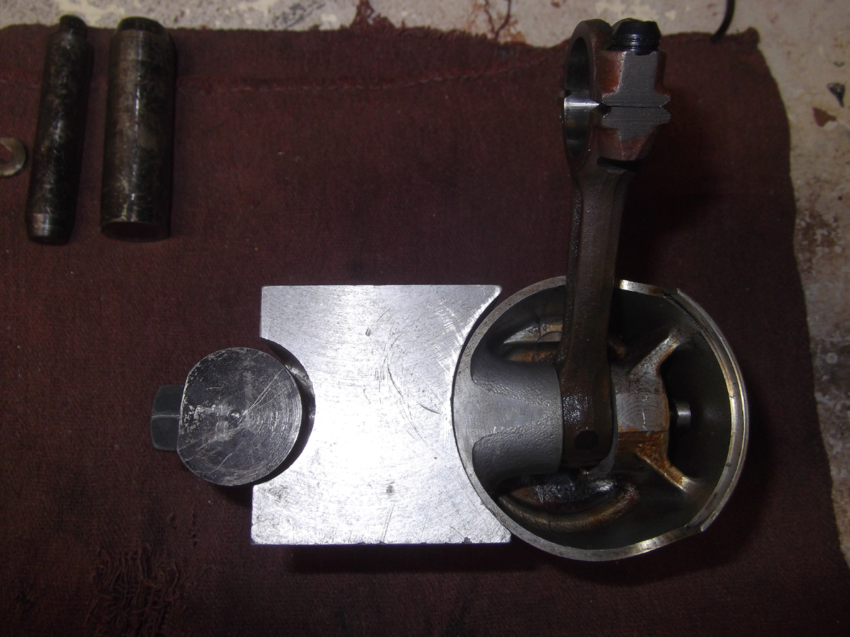

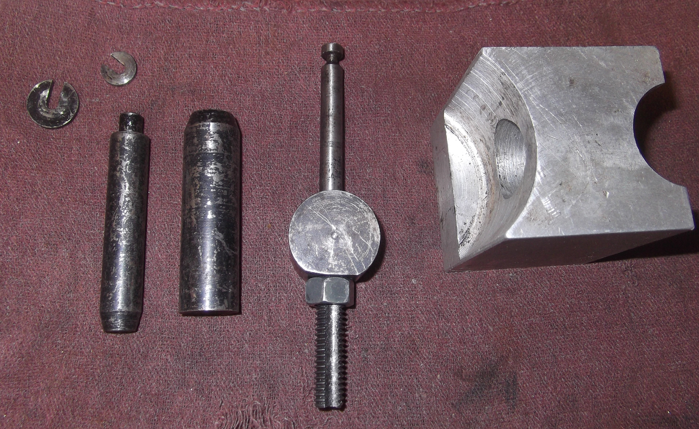

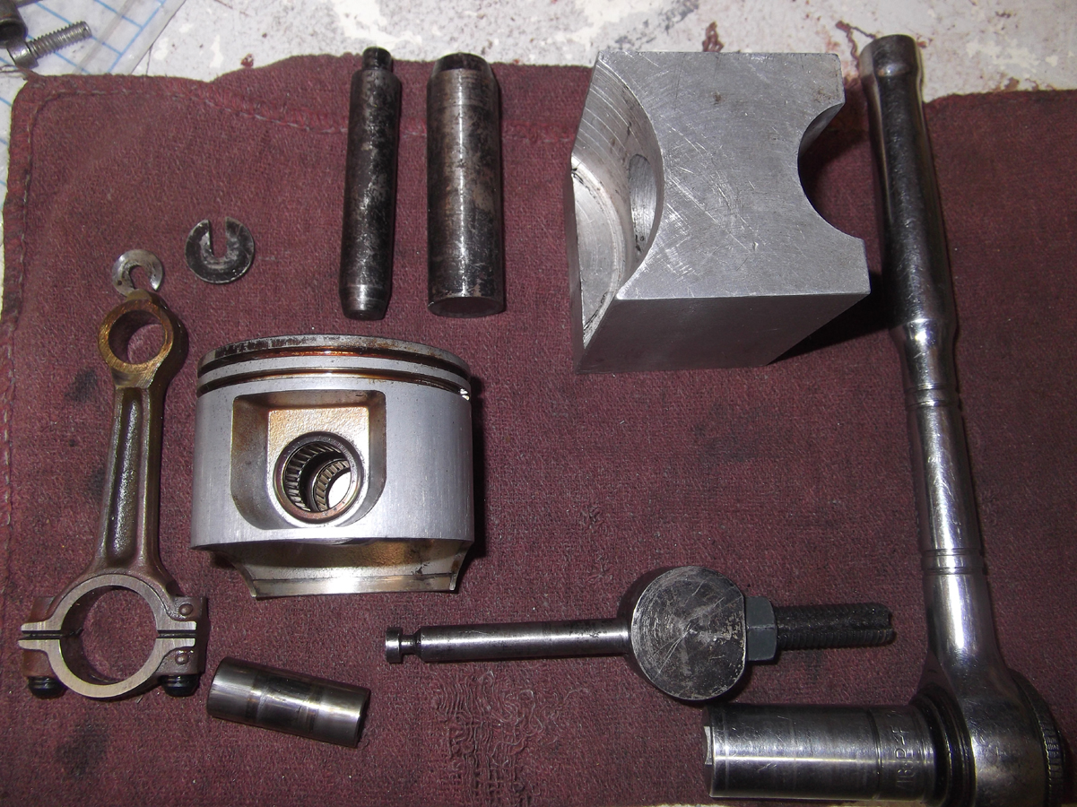

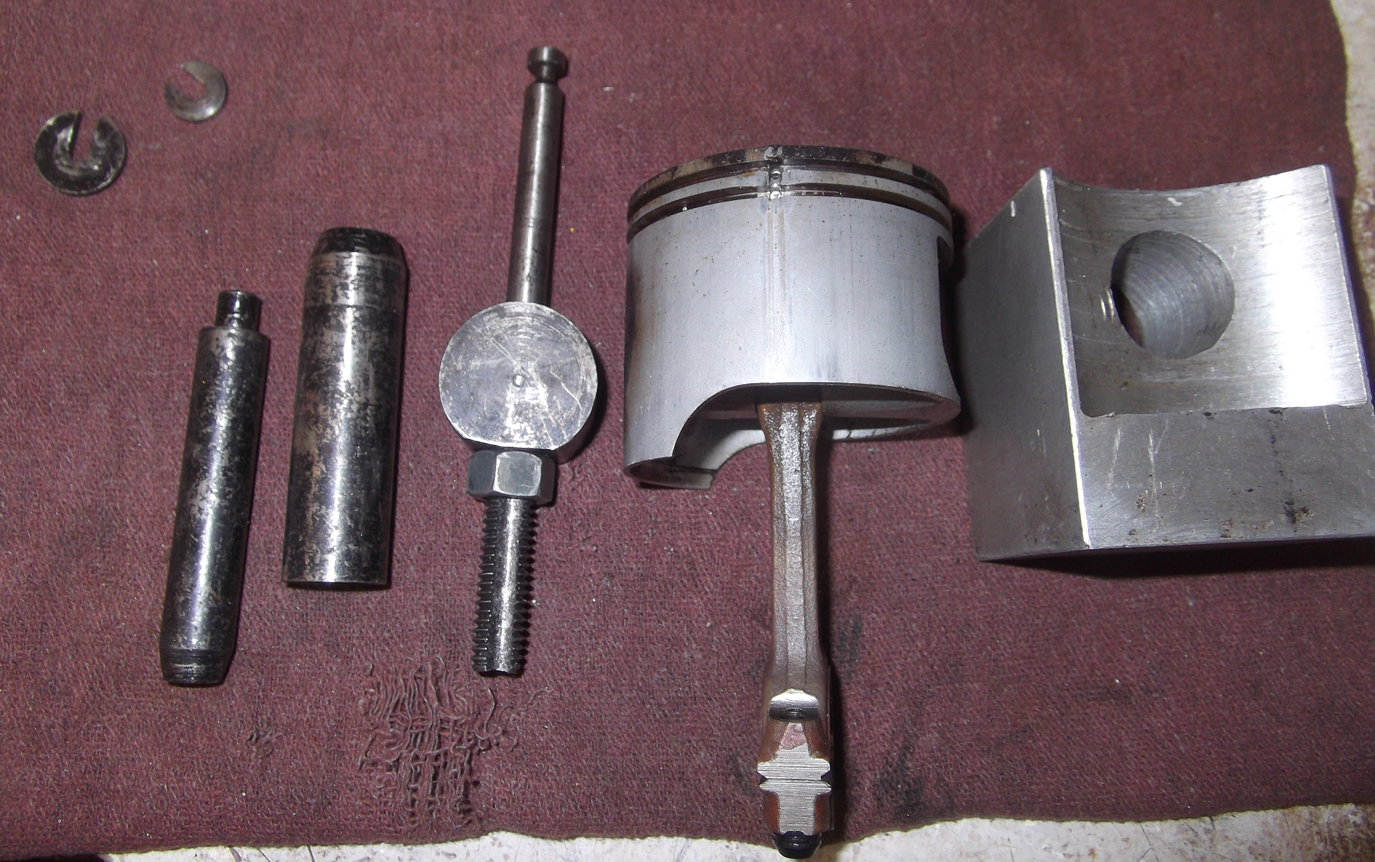

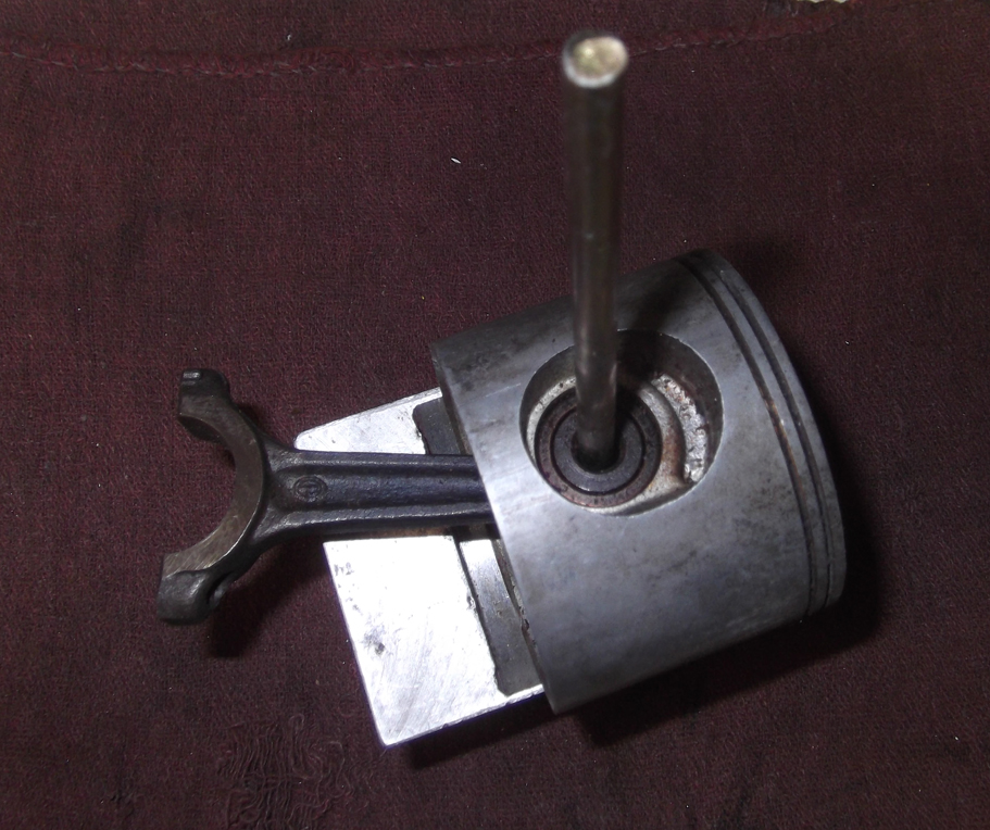

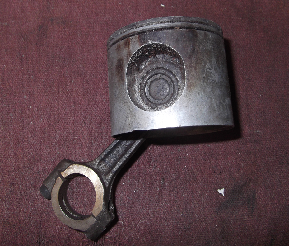

This 797 puked out its top ring locating pin and chaos ensued. The first two pictures showed the complete dismounting tool. The smaller retaining disc is for the
1/2" wrist pins, the large disc is for 9/16". The next picture shows getting the tool in place with the piston and lining up the extraction rod and retaining disc. You
can verify that you have everything lined up good when the retaining disc ends up flush just inside the needle bearing.
