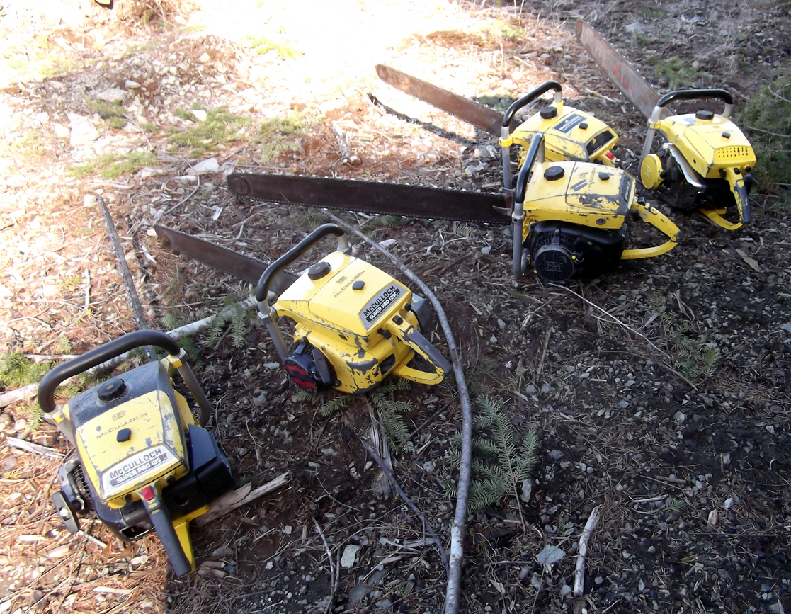

This a .030" over iron-liner saw that got a new piston and Wiseco chrome-lined rings. It's also running an SDC-20 carb. Chain is vintage NOS Oregon 52-AL "Micro-Chisel", which is
not a real square-ground chain, it's more of a semi-chisel type chain. It was originally made for working on landings in dirty/muddy cutting conditions. The roll I have is from the
late 70's. The wood is Mountain Hemlock.

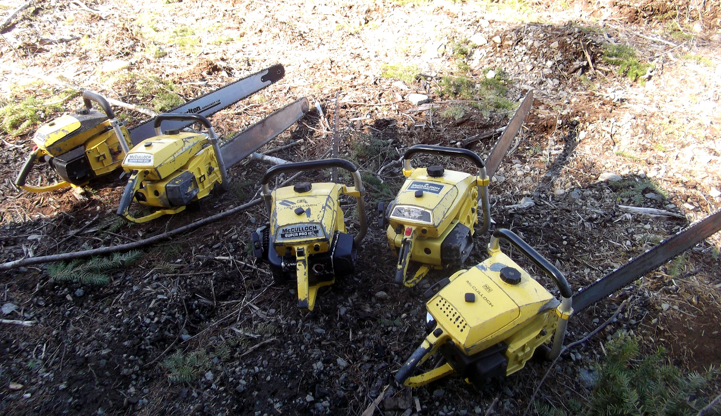

This is another .030" over saw, this one got a 101D .030" over "Nine-port" piston on a 1/2" wrist pin. These .030" over saws just pull like a tractor. This one is also
running the Oregon 52AL Micro-Chisel chain on a 42" Cannon bar.

Ok Jacob, I haven’t seen the heat shield like that before on the the saw with the red kill switch and the black tank, what’s the story on that?
I'll post some close-up pictures of those tomorrow. I found two of them in that junk that I got from the guy in Bridge in '99 - I think they're a later cover. I haven't found them
in any of the IPLs yet.
Ok cool! It was really standing out to me! I haven’t seen one before! I like the wide bars too! You done see them every day either!
That one has a different sound to it. Same mufflers as the other ones?
It doesn't have the "squirrel cage" in it (a round cage they use for spark arresting/debris blockage). In person, it's howling loud. It hurt my ears even through ear plugs.
