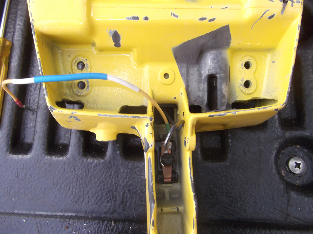

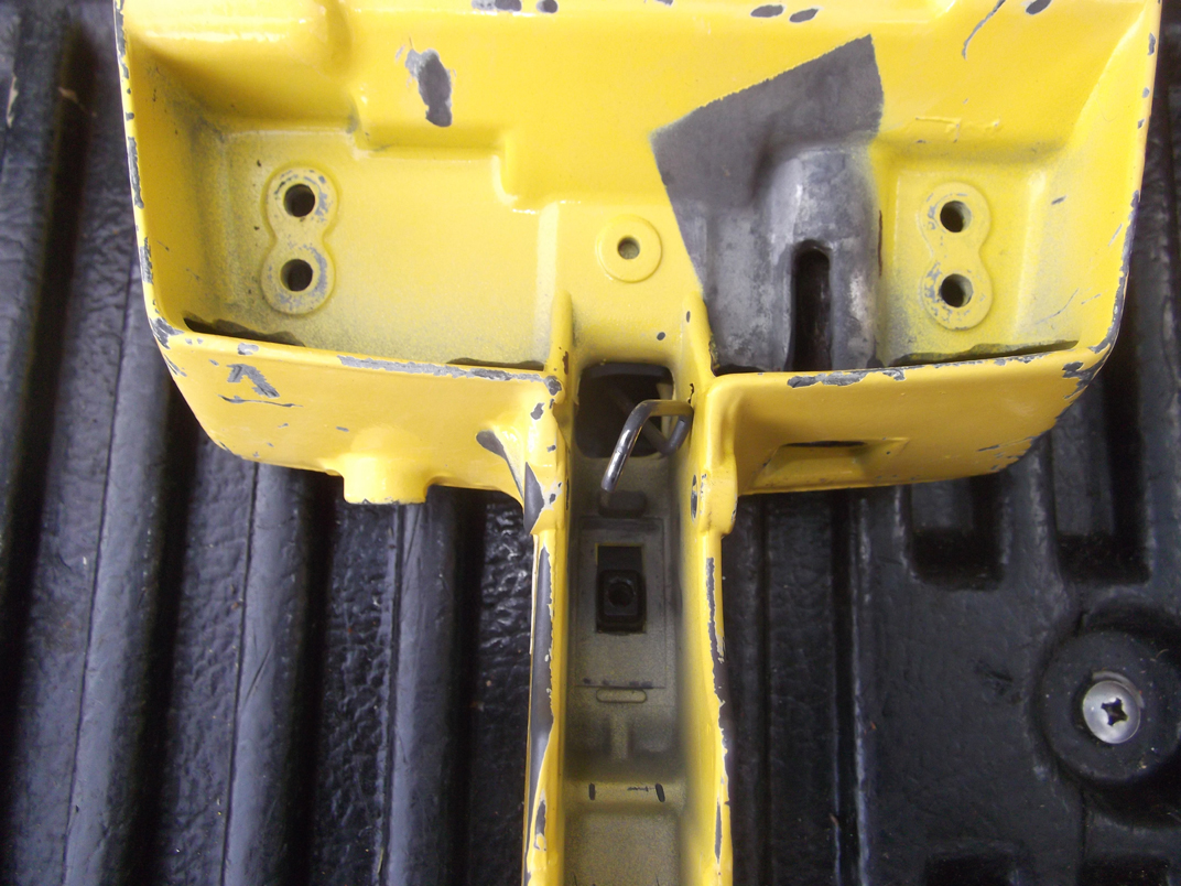

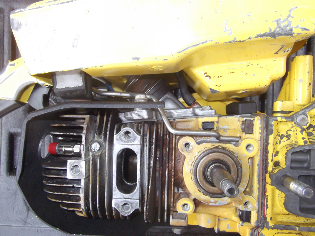

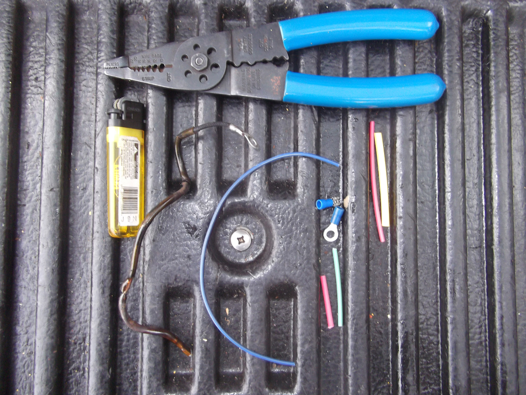

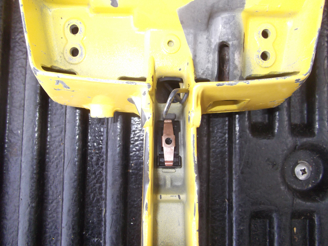

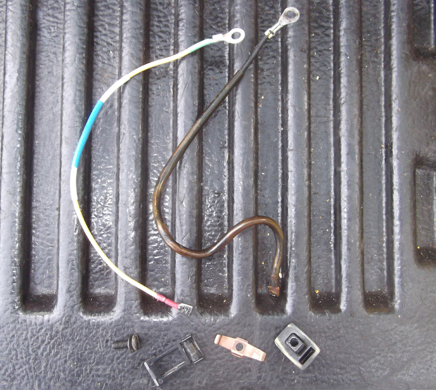

I got time to do more 125 build stuff today, and wanted to go over the on/off switch, kill wire, and trigger replacement. The trigger in my current tank was broken and the on/off switch
wasn't working anymore. The 125's use a plastic on/off button with a plastic slide and a copper grounding tab. The kill switch wire screws into the on/off button and hooks to a grounding
tab on the coil. It's a simple, smart design but the wire has a plastic coating which hardens over time and breaks. It's easy enough to make a new replacement with bulk wire, heat shrink,
and crimp connectors.

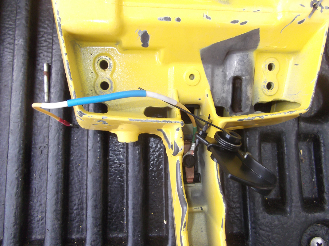

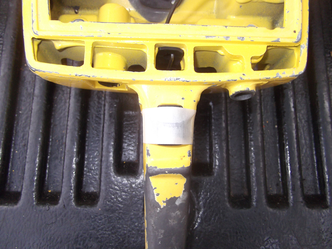

To install the mess - I start with taping the on/off switch knob to the tank, and the lining up the copper grounding tab. Then I bend the end of the kill switch wire and insert the clamping screw,
and line it all up and gently start the screw.

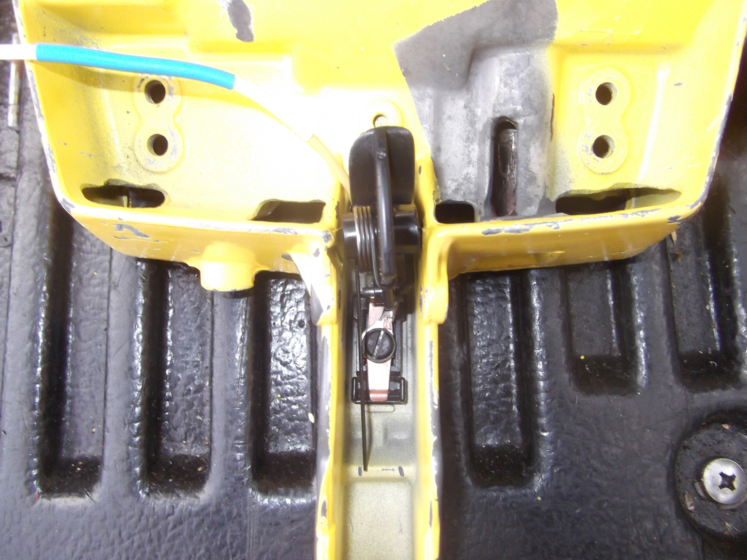

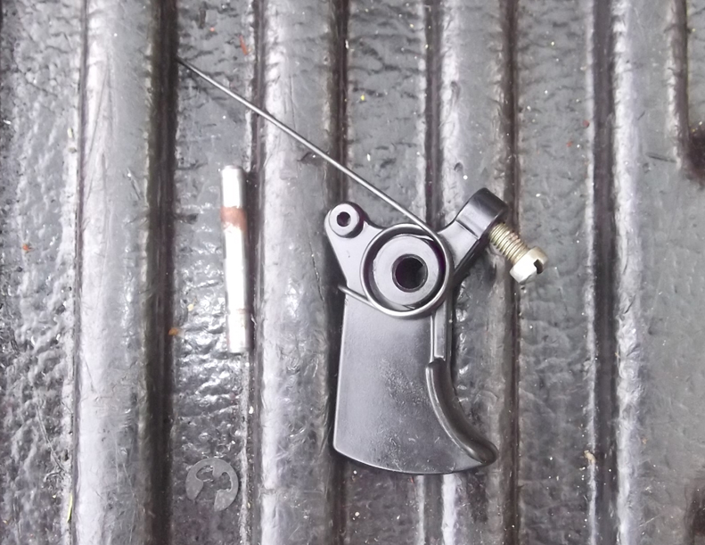

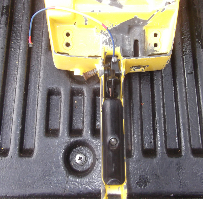

Installing the throttle trigger - You have to pull the throttle rod back a bit to get clearance from the pistol grip. Then you hook the trigger to the rod, and keep the tension spring
tucked inside the piston grip. On any used tank, there should be witness marks where the back of the tension spring rests.

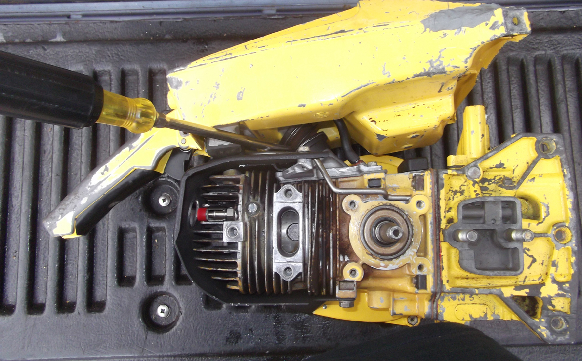

Getting ready to install the tank on the short block - I usually pull the impulse hose out of the tank and install it on the manifold first. I also get the manual oiler rod lined up
and set the manual oiler button out about halfway.

I think the hardest part for most people is getting the intake boot worked on, especially if it's used and has stiffened up over time. I keep a longer flat-head screwdriver inserted in the lower part
of the intake boot spring while I'm working the whole mess on, and then use the screwdriver to carefully work the boot on. You'll feel it kind of 'snap' into place when the retaining lip of the boot
meshes up with the rolled lip on the manifold.

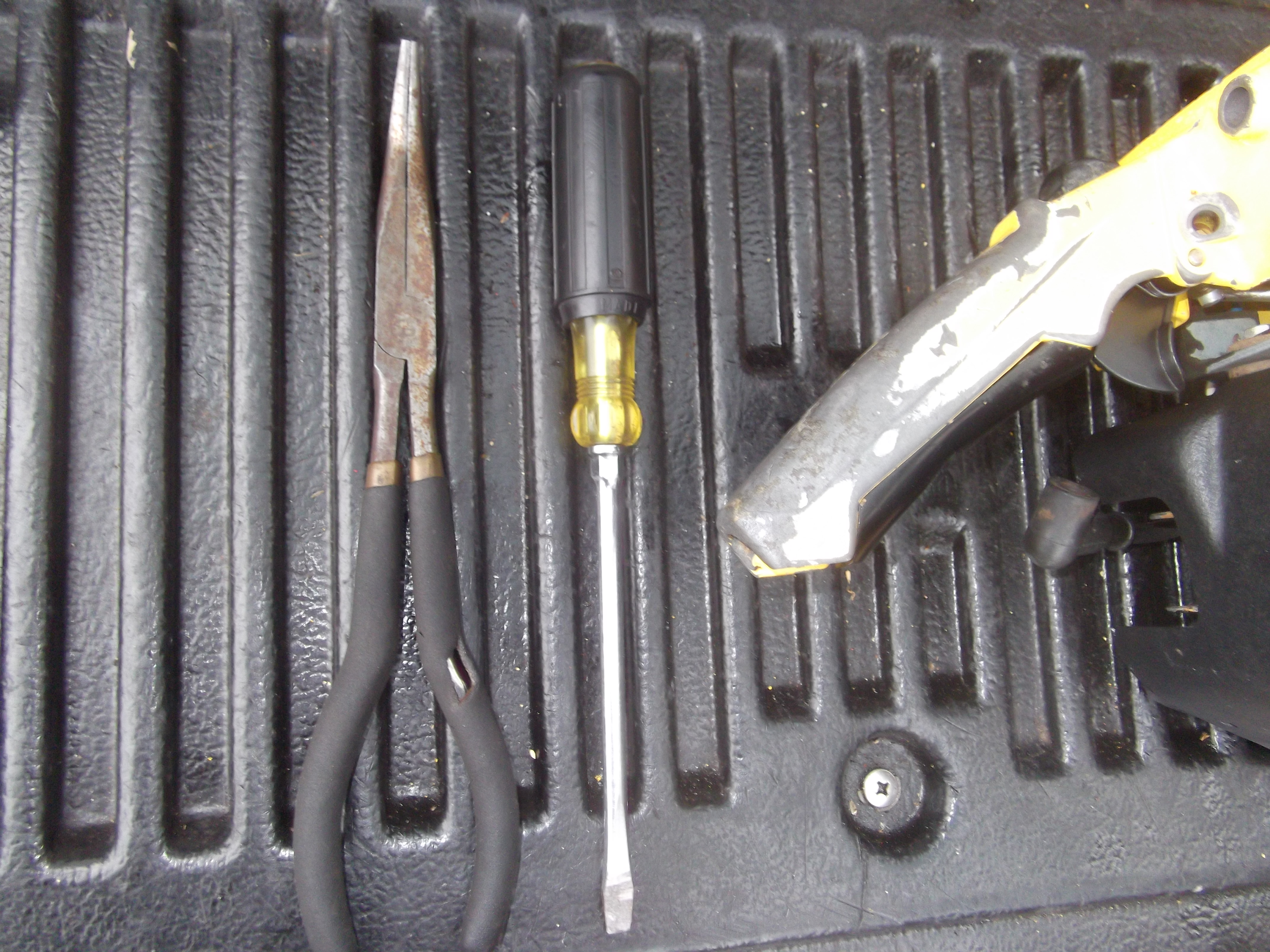

I use these tools mainly when installing the tank - long flat head screwdriver and long, curved needle nose pliers. McCulloch had a specialty tool for installing the
boot which sort of looked like a cross between a ball joint/tie rod fork and a spatula. It allowed the technician to apply even pressure on the bottom of the boot
while slipping it on the manifold.

Very nice JJ, Sounds great. A little tip to installing the intake boot
to the intake manifold. I used stp oil treatment on both the boot and
manifold, The old style stp is slicker than snot on a door knob. Boot
pops right on with a little push with a screw driver.
