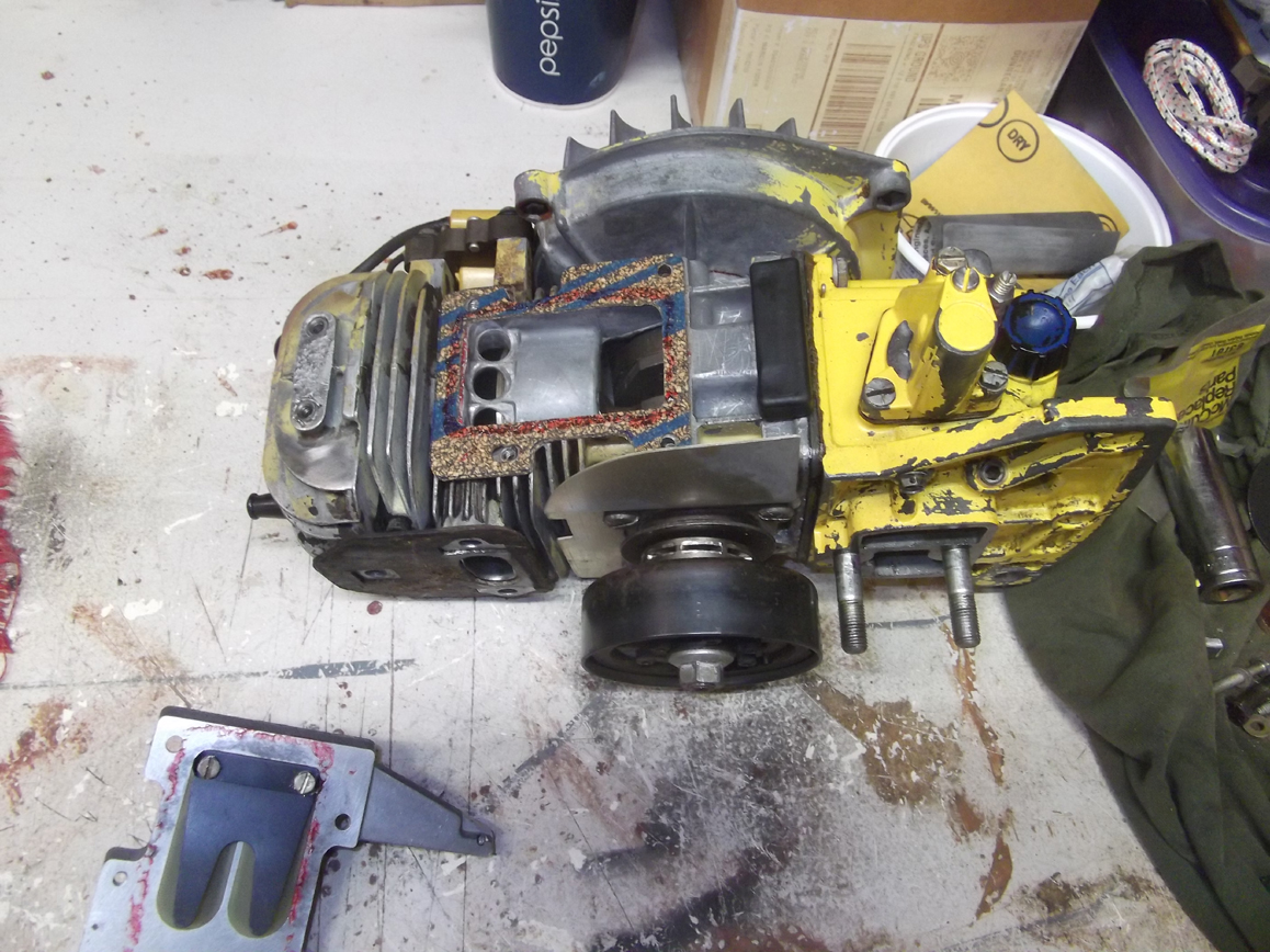

I made quite a bit of progress today - we were without power for the first part of the day so I was working by spotlight. I lapped the intake manifold and hand-cut a new intake gasket.
I put a thin layer of Loctite 518 on both sides. I also ensured that the intake manifold sits flush and that the reeds fit flat and even on the manifold.

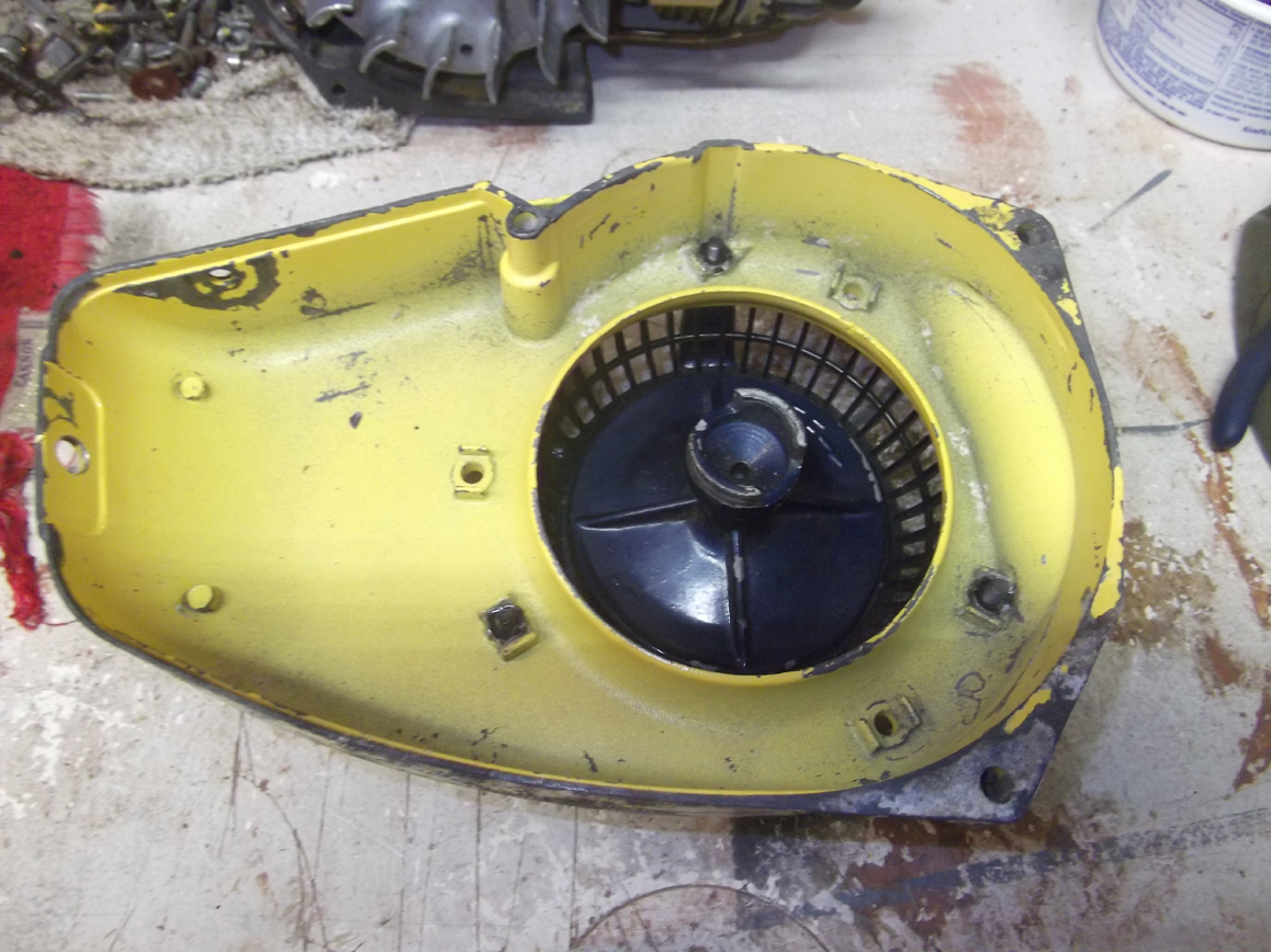

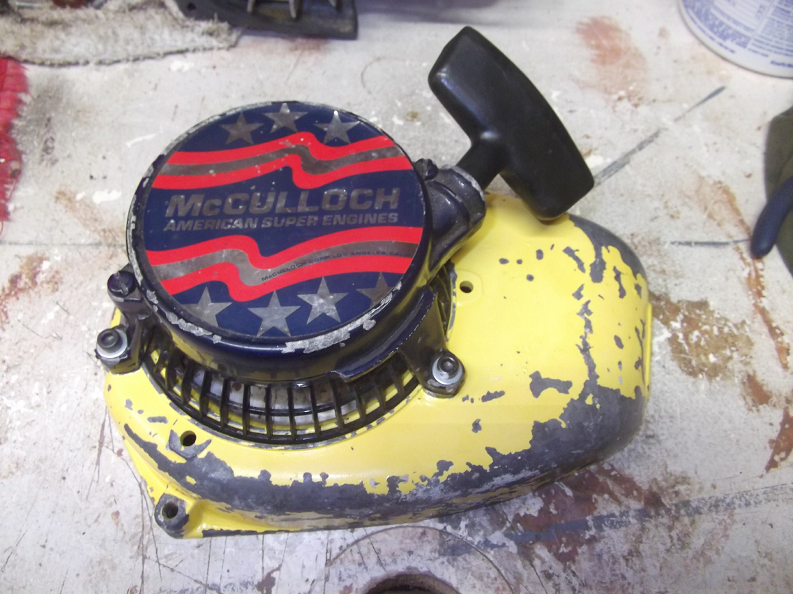

I got the starter fixed up - it's an old 101 starter from one of the 101AA red, white, & blue engines. After setting the tension on the spool, I lubed it with PB Blaster "Dry" aerosol.
I set the mounting nuts in the shroud with Shoe-Goo. I think originally they used some sort of epoxy.

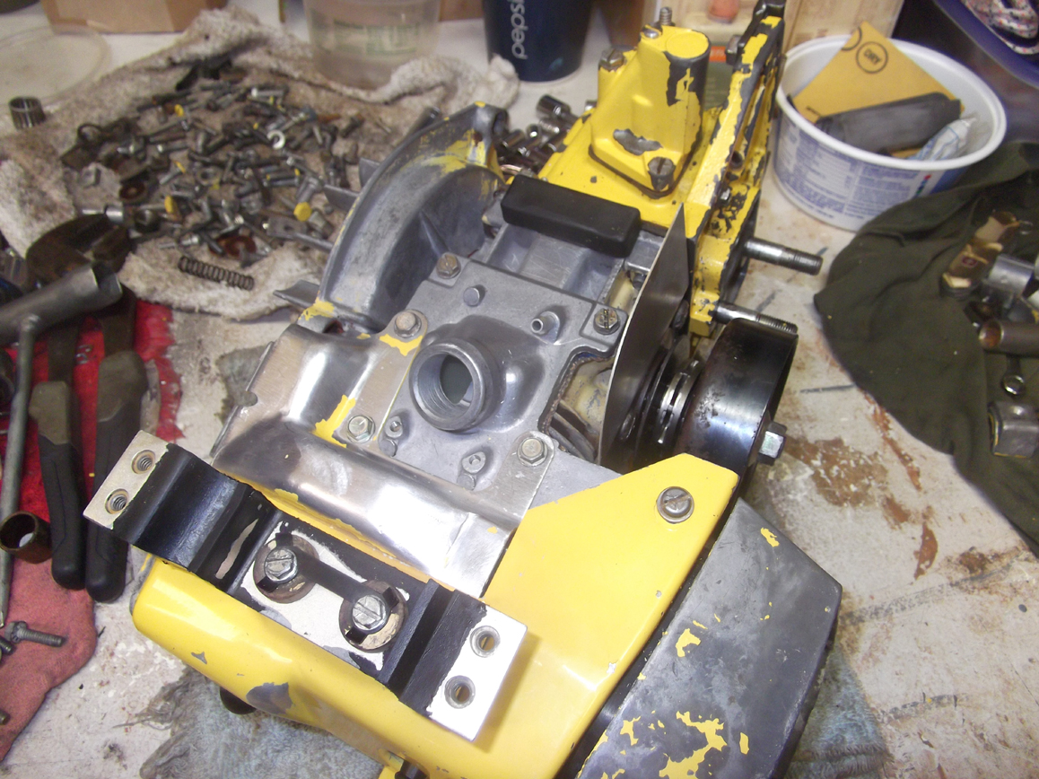

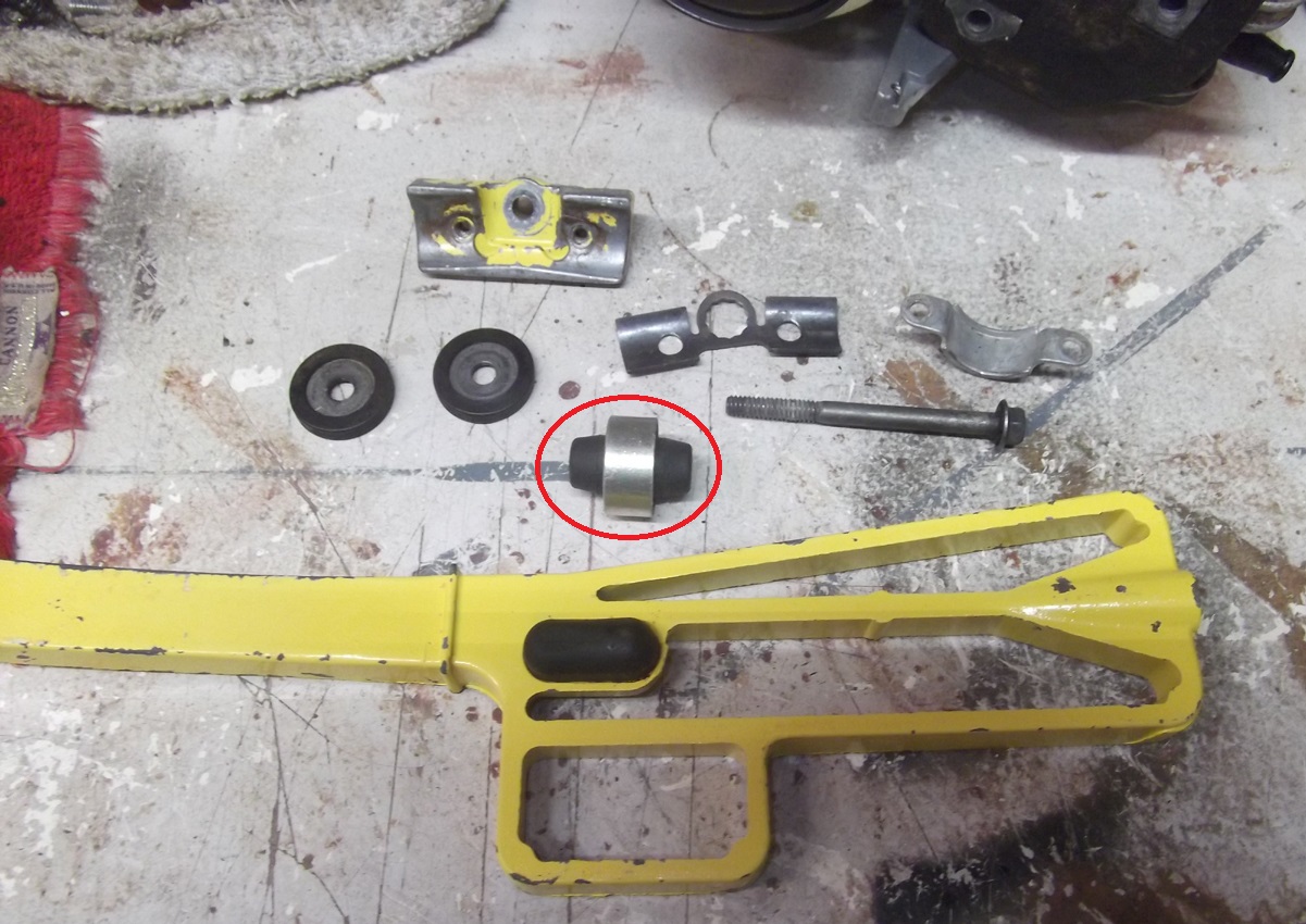

Next up, I go for mounting the bottom strap. It's part of the vibration isolation on the 125s, and the mount that's circled is the one that usually falls apart.
I've seen some re-pops made of those but I don't know who is behind that. I found NOS on ebay a few months ago.

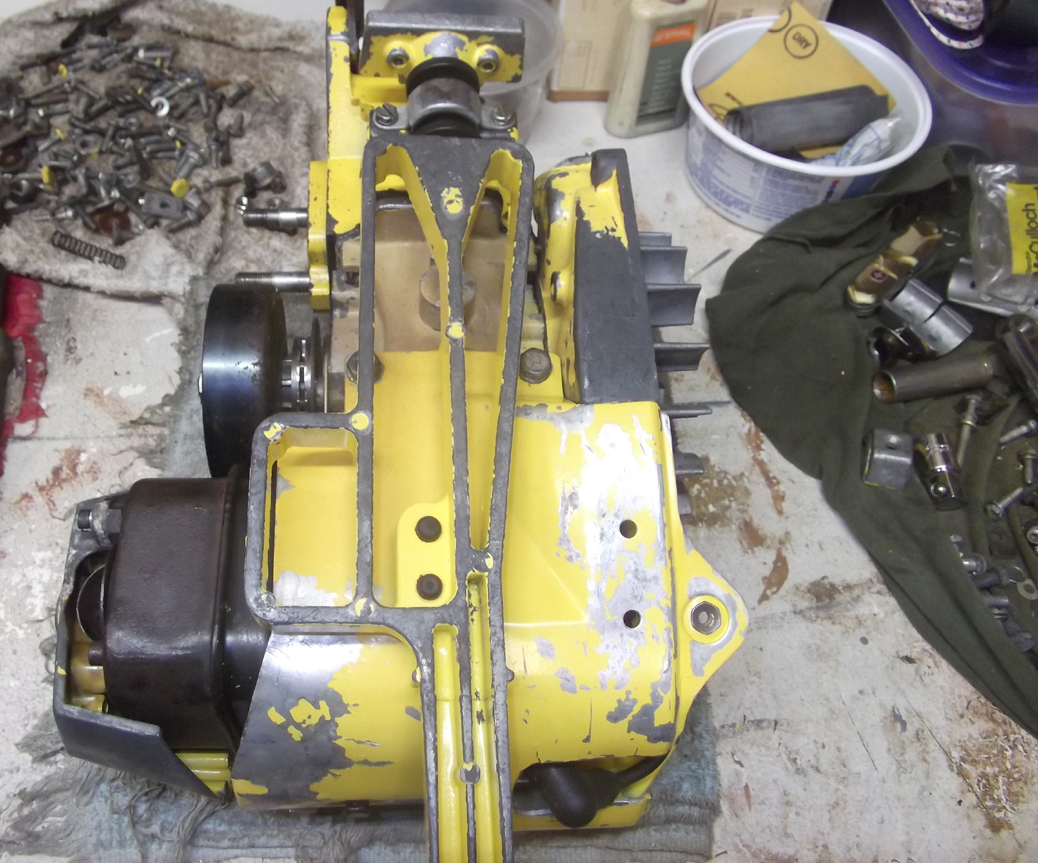

I went ahead and installed the manifold, 1/4 shroud, and rear vibration mount. I line everything up for the rear vibration mount first and start the screws, then go back and start
the screws for everything else to ensure it all lines up.

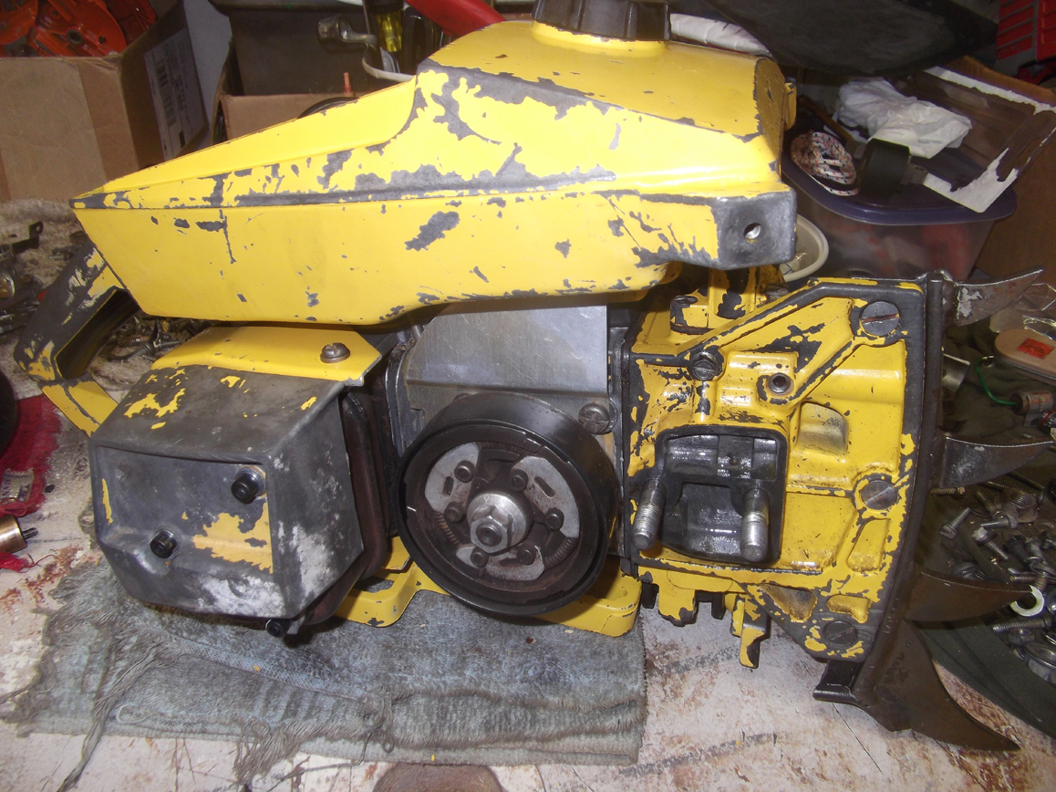

It's starting to come together - this saw got clobbered at some point and the cylinder shroud was caved in at two areas and bent pretty good. I was
able to straighten it out quite a bit with a small ball-peen hammer on a Maple stump. It's still not totally lined up - two of the mounting holes for the
starter are a little off, so I'll rectify that tomorrow.
That's a part I need to track down. Mine is pretty worn out. It's looking great Jacob.
They're usually on ebay. I think I was searching for parts for a Super Pro 81 when I spotted it. It may have been Bryce that did the re-pops and was selling
them for $18 apiece.
