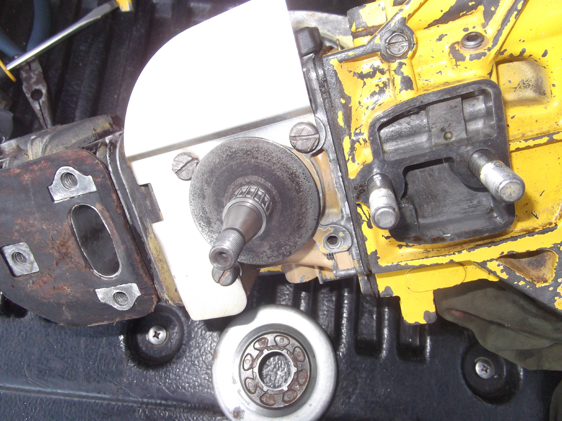

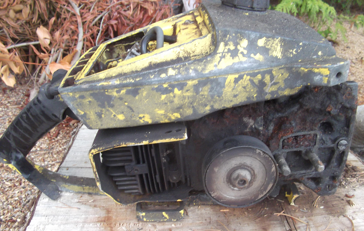

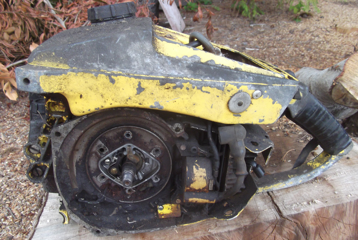

I didn't get a whole lot done today since the weather was nice again and I needed to get the front of the house buttoned up painting wise, but I got a bunch of parts cleaned and got the short block finished.
In this picture, I pulled the flywheel and finished up the backing plate and points cover - I think I have the straps correct, but if I don't one of you boys can point me in the right direction. The one strap, circled
in blue, has a lip that contours with the recess for the weep containment. I make sure the points cover is clean and dry - my dad used to put grease on the lip to keep water out of the points but I've never had
an issue with that (of course, I'm not running these saws to make a living).
