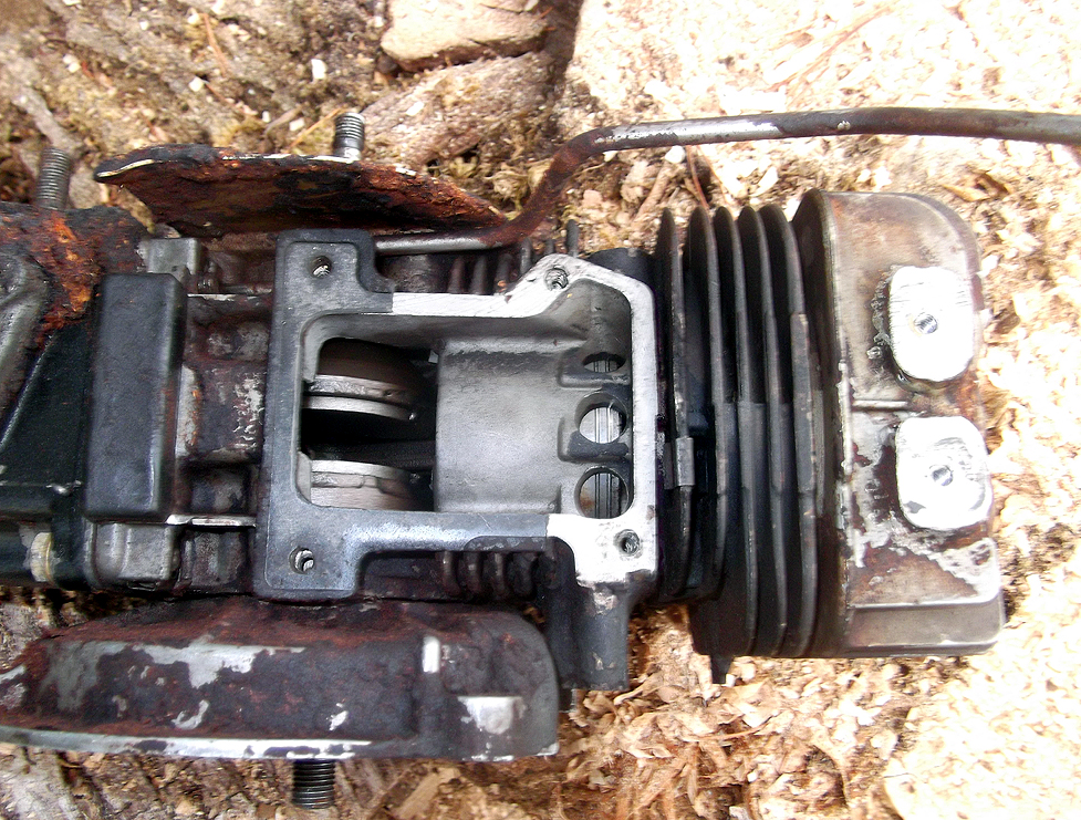

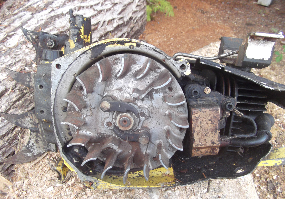

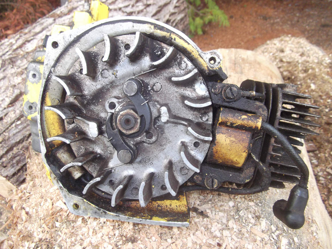

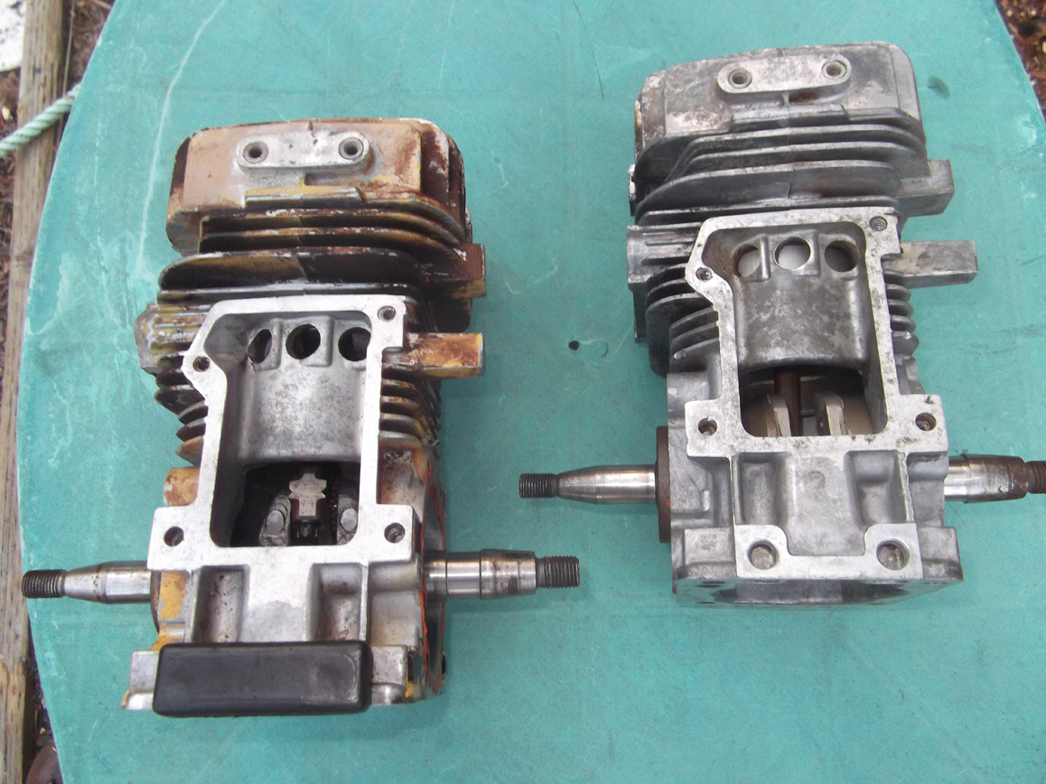

A few other pictures - Mike, this picture shows that Mac shoebox saw coil on an SP block - I know it's a non-limited, electronic coil. I'm not sure if my dad swapped
the laminates out or not, so I'll investigate that. I know McBob did something similar with a Poulan coil.

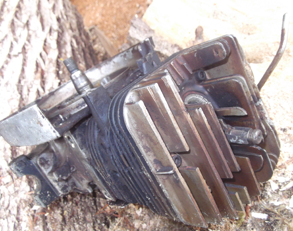

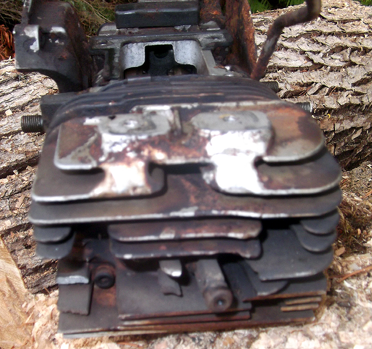

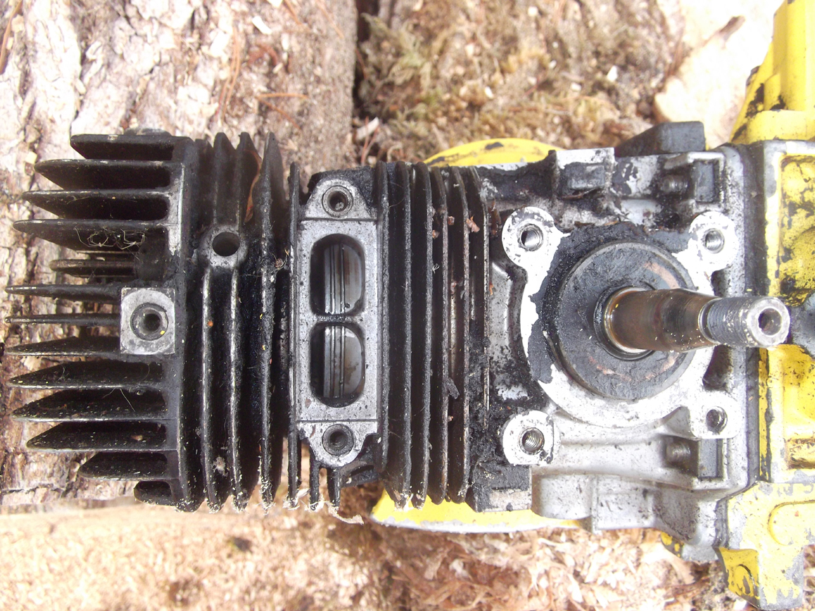

These two pictures show the CP engine in the SP frame - you can see the horizontal-leg coil and the DSP-style compression release port. It's a stock bore cylinder as far as I know. My dad bought the cylinder new as a replacement part - it has no ID numbers and is not a boost port block.
Thank you for the pics Jacob. How soon do you think you will start on your dads saw?
Dose that cp block have the 101 bumps for the boost port area?
I have a 394, a 346, and a Dolmar 120si to build for members here and then I'll launch into my old man's three saws. I'll do that CP conversion saw first, so we can see how
that all goes together.
That’s cool! And even has the 125 bolt on counterweight crank
My dad said it was really smooth - it was his favorite saw of the all. I chipped off about five pounds of old-growth Douglas fir sawdust and pitch from the engine. He
ran a 60" bar on it.

That’s cool history! I have 2 original 101b blocks that were original saw converted, both stock bore and covered in pitch chips and oil! They smelled amazing! Lol
