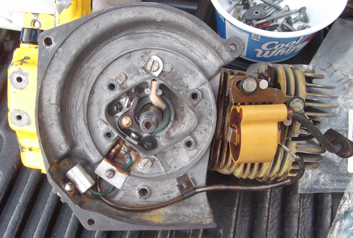

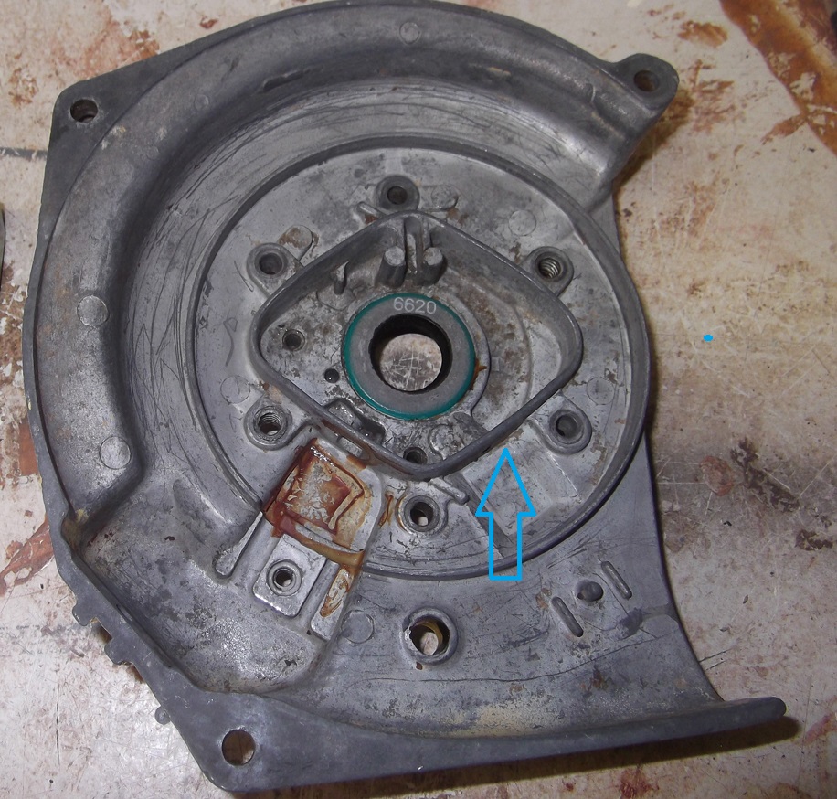

I haven't made a whole lot of progress on this guys (last night was nice after work so I got a couple hours of painting in), but I'm starting to get the engine buttoned up.
Lee and Mark H. mentioned over in the CP-125 build thread last year that the ignition backing plate uses two seals, and a piece of felt in a recess to catch fuel mix weeping
from a drain hole that accesses the race in between where the two seals would be. Since the existing seals in this saw are hard as a rock, I went with an SKF 6620 seal. I've
had good luck with these in other applications. This will be an occasional use saw so I'm not too worried about mix weeping into the points. Here I've got an arrow pointing to where the
plastic washer, plastic seat, retainer, and hardware goes for the coil wire, condenser wire, and the points tension spring.

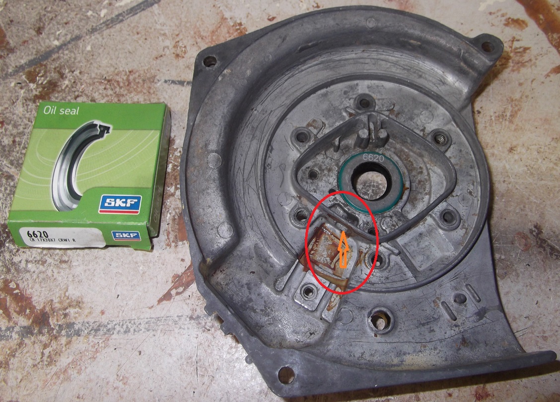

This picture shows where the excess fuel would weep out - there would be a piece of felt held in here with a clear piece of plastic epoxied in place.

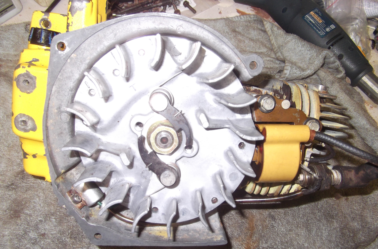

I got the backing plate installed - I use a thin layer of Loctite 518 on the crankcase flange where the back of the plate interfaces with the crankcase. In some saws, I've seen
a thin rubber O-ring between the backing plate and the crankcase, but I don't know if that was original from the factory or something that someone did later. Here, I have
everything mocked up. When I rolled the crank over, I could see that the existing points wouldn't close all the way, no matter how I adjusted them. So I dug through my
parts box and found a much nicer looking set of points and got them seated and adjusted correctly.
jacob j.
Only the weird
7:04 AM
232
9,797
67,296
Coastal Oregon
After getting the new points installed, and getting everything snugged up, I installed the flywheel and torqued the new flywheel nut down snugly, and
spun everything over with my cordless drill - we have fat, blue spark. Tomorrow, I'll pull the flywheel and install the rest of the backing plate screws,
the points cover and retainers, and torque the new flywheel nut to 375-425 inch-pounds.

So you use just the one seal? How was the chrome on the other cylinder?
Yessir, just the one seal. The 6620 is a thick seal and it blocks the "weep" hole. I'm not really too worried about weep - that's from an era
when 16:1 was the standard mix. This saw will run 32:1 of the "good stuff."
