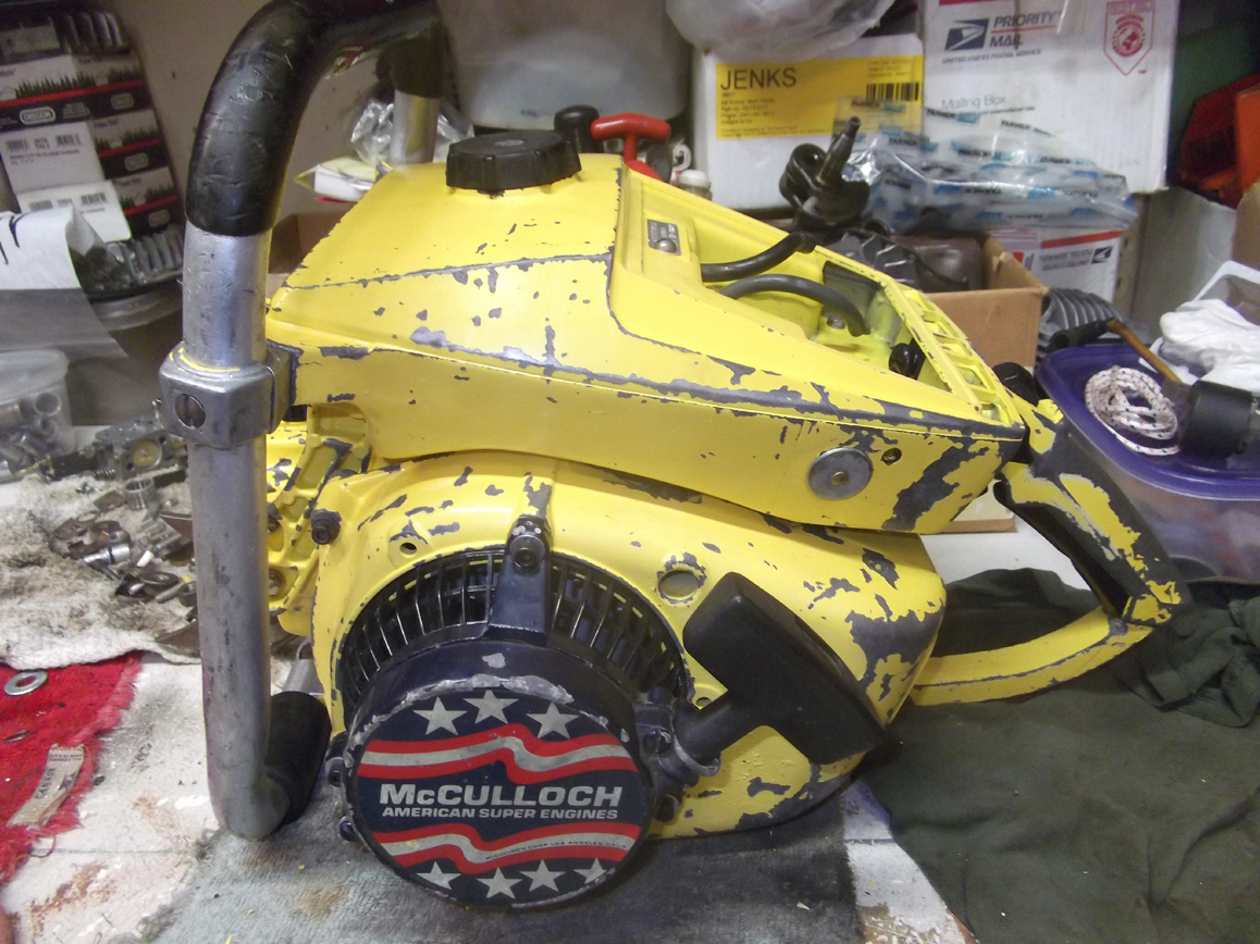

Well, the saw is complete and a runner, but needs a few things touched up: The current clutch is pretty well worn out, but I've got a new replacement (somewhere), and the
air filter needs replaced but is functional. I need to swap the handle out for a better one later (this one has been clobbered and has a saw cut in the top, but is working).

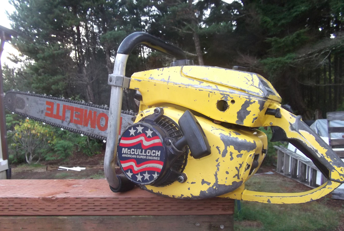

Overall though, I'm pretty happy with it - here it is idling, after its first start-up:
Here's a couple of cuts in Silver Maple with a 28" bar and chain:

That's what it is running now and it's doing pretty good so far, but I think I can get more out of it and keep it under the lid...

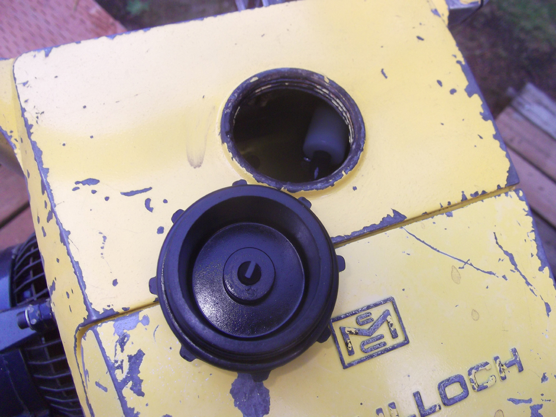

A couple more notes - I was able to get new O-rings (1 7/8" x 1/8") for the fuel cap from the hardware store. For a duckbill valve,
I used a valve from a Stihl brush cutter that goes inside the tank vent. I'll find the Stihl part number for it. The rim of the opening to
the tank is pretty rough from moisture damage, so I'll lightly block sand that later to make it even.
