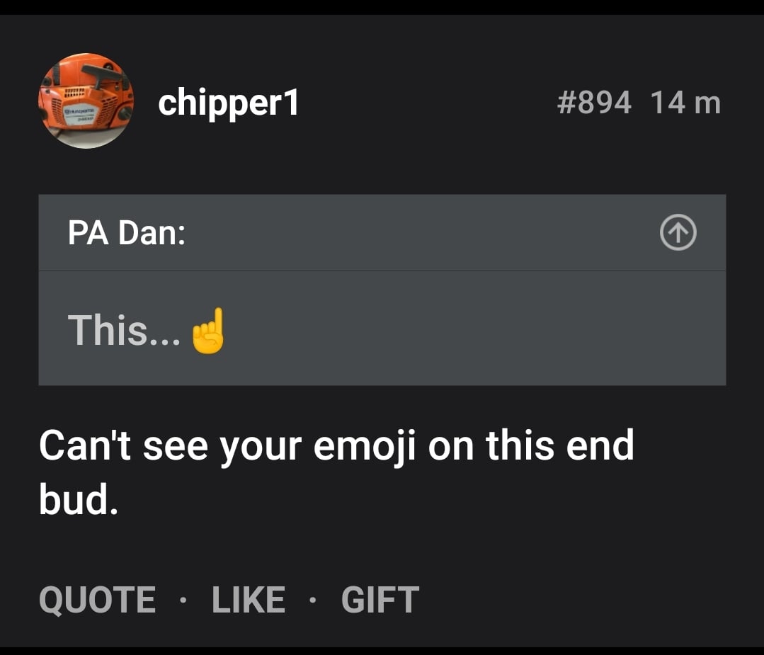

Can't see your emoji on this end bud.
This...
