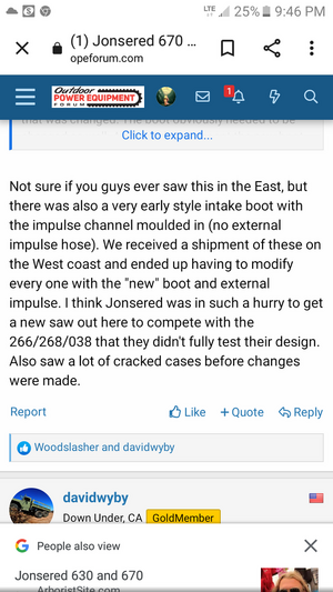

Looking good @Spike60, Bob I'm sure you are more than covered but if you need anything let me know. I still have quite a bit of stuff for these saws.
I have owned a ton of these and I agree with you Bob on the intake boot issues, I haven't seen or experienced any issues either.

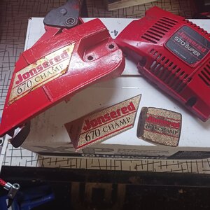

Last 2 items for this afternoon. Want to open up the muffler a little bit, but not this one. Should have one around with the screw on deflector and I can get in there and hog it out, but retain a stock look. That and the gasket delete are the only mods. I don't do any legitimate porting like many of you guys. If I was to rank myself among the top 100 porters, I'd come in about 900. A lot of you guys do some amazing work I will say!

Those rubber intakes would get cut from the twist wire that was around it, or less the less likely flat clamp style. Probably from being over tightened. The only saw of that era that would hold its own with a 670 was the 268 xp version closed port cylinder

Yep......essentially the exact same P&C as far as porting and timing goes, just with different impulse routing and intake setup.
