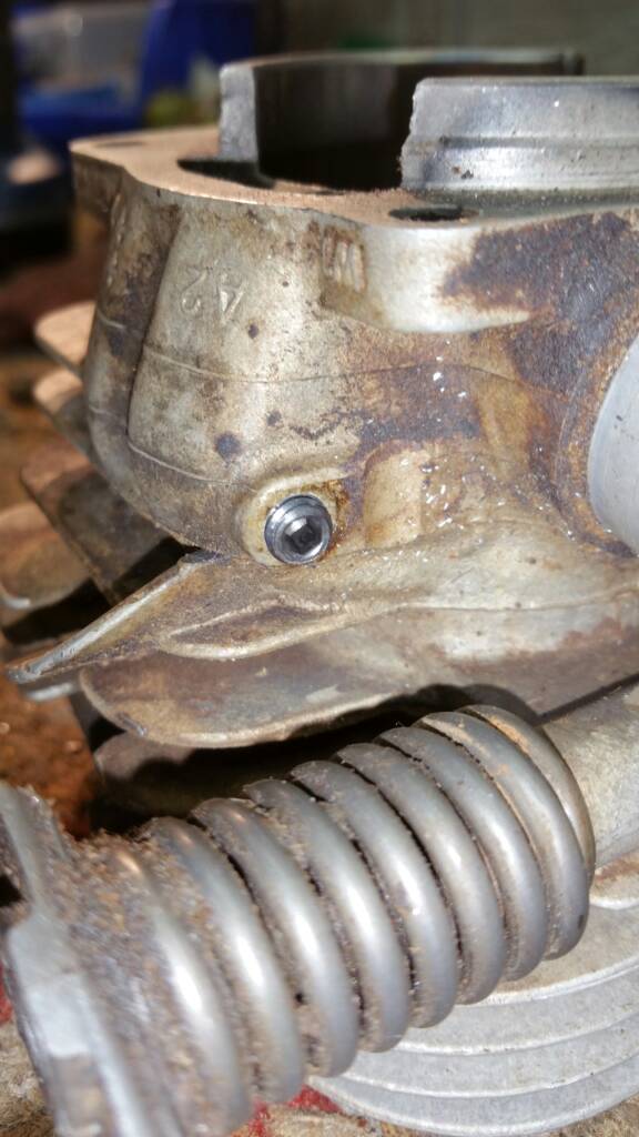

I tapped that hole and used a set screw with loctite
its the same way I do with them, I didnt trust the normal locktite so I used 518. I dont plan to take out the screw again lol

I used a 10-32 set screw i happened to have on hand +518.. my parts arived last night and i should have done my research on this, but i read somewhere about using a 372 intake clamp on the 357.. the clamps arrived and are much too large. I really dropped the ball on this one. Didnt even look at my 372 to compare before ordering..
