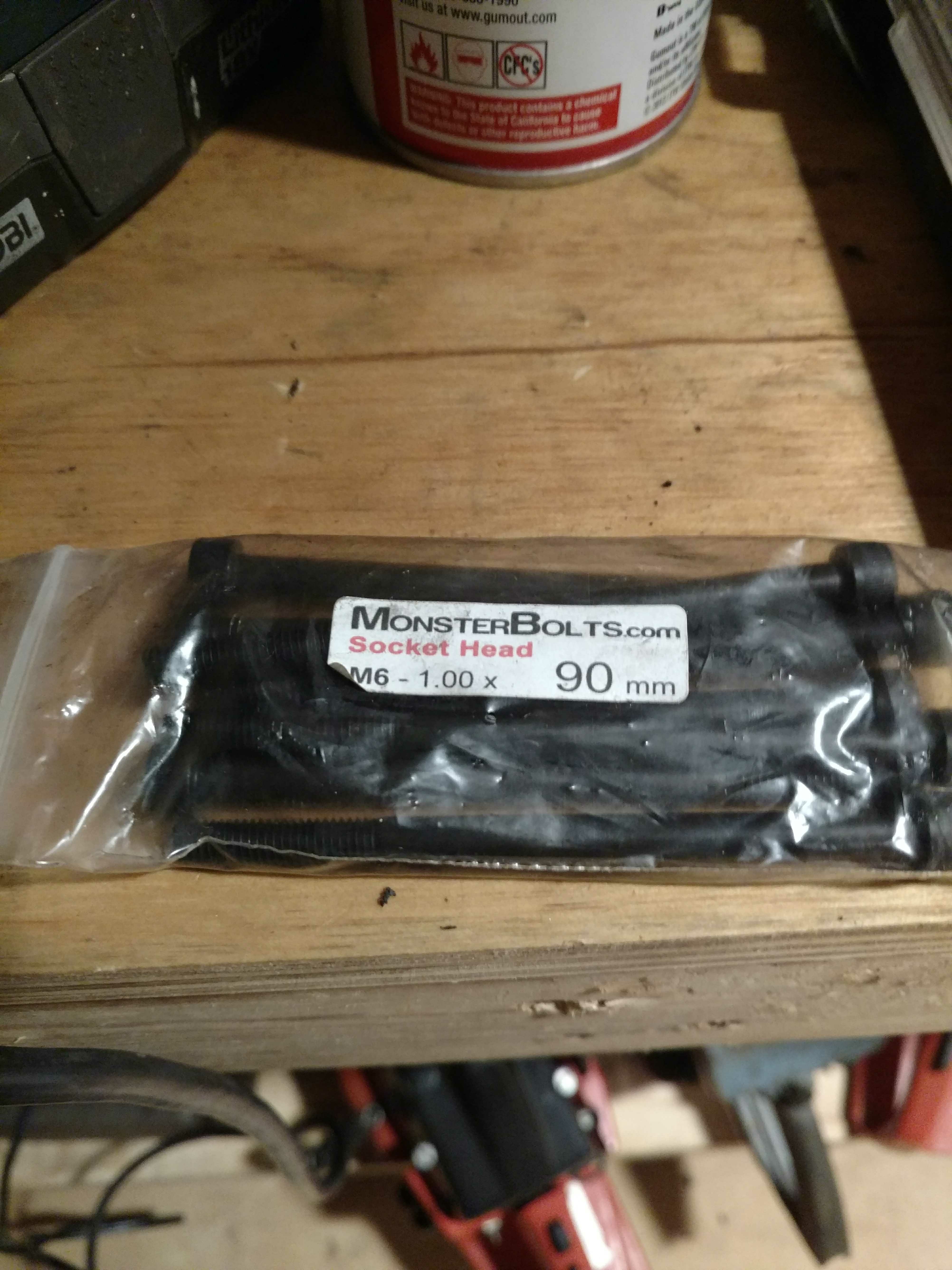

288 muffler bolts work at 6mm. You have to ream the muffler tubes with a drill bit. I can't remember the length of them but I think it's these.

These are the bolts I used. Got them from a hardware store. I drilled and tapped the muffler flange, and like Keith said you have to ream the muffler holes out to fit.
