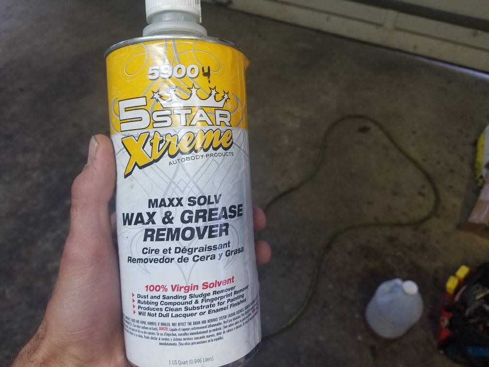

What do you guys use to clean the surfaces with before you put sealant on? I was using brake clean, then switched to wax and grease remover. The bond has been alot stronger with hondabond ht.

I still use brake cleaner... maybe I'm behind the times.
Oddly enough, CRC brakleen is designed to leave no film, but i find it leaves more residue than even carb/choke cleaner. My favorite if I want something really dry and clean is CRC MAF Sensor cleaner. It is pricey stuff but worth it. It evaporates cleanly with no residue left behind. I use it at work all the time for cleaning MAFs (as its intended) and have been impressed with it. If something is really nasty, brakleen first as it's cheaper, then MAF cleaner to finish it off.

As far as removing sealant residue, I use a tiny soft stainless brush on my Dremel. Works freakin awesome!!!!
Finish cleaning up with B12 Chemtool carb cleaner.
Re-seal all clammies I've done with Yamabond 4.
So far, so good!!
I've used the maf spray a couple times also. Works great.
