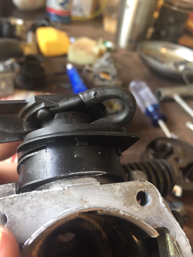

This ended up being part of my problem on my 350. (Tore the saw apart 5 times before figuring it out)
I know it looks pretty obvious in the picture but It becomes invisible when I'm not bending the house. Even more so when installed onto the nipple
It would pass pressure and vac test when installed. (I plug off carb and exhaust and test through the spark plug hole)
