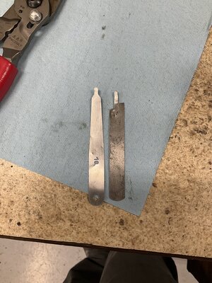

You can buy a feeler gauge from Stihl or trim your own. Turn the engine over until the intake valve has shut and the piston is at the top of the cylinder. The valve clearance should be .004”

The whole point of having valve lash is that it allows the system to warm up without holding open the valves. I never adjust with them warm.
