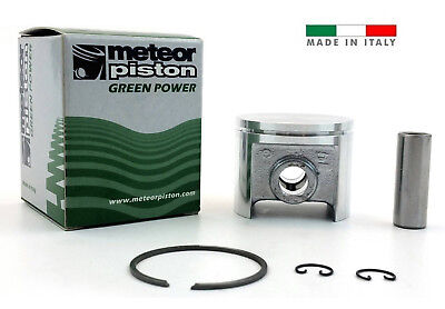

Meteor makes a 266 and a 268 fully windowed piston, always wanted to compare the two side by side but never have to actually see what if any difference there is between the two of them. They do have different part numbers so there must be a little something I'm not noticing. They do run well, even in the modified saws and are my piston of choice.

8:19 AM
34,546
196,725
Meteor
Oem
Oem
Meteor
All 266 pistons
Did i miss any?
Suprised at the amount of oem 112.00+ though

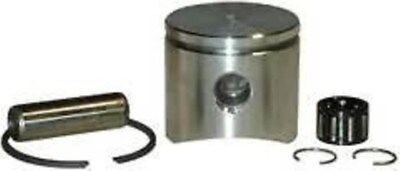

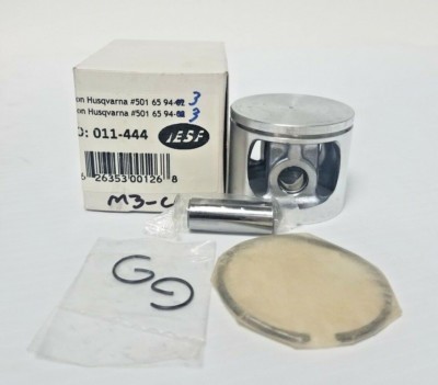

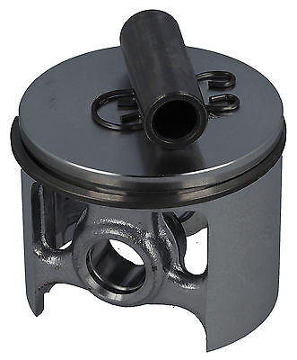

The hyway are well stamped they are proud of theirs comes with a caber too.
Never saw another china am stamped piston.20190905_110313.jpghere's a 268 popup
But they are meteor price now.
I've got a couple of these should make a 266 more fun to start.
8:19 AM
34,546
196,725
One in the middle is a 66 piston I believe. One on the bottom a 268 slab sided for the open port cylinder. Meteor has two for the 268.
They are all sold as 266 online
