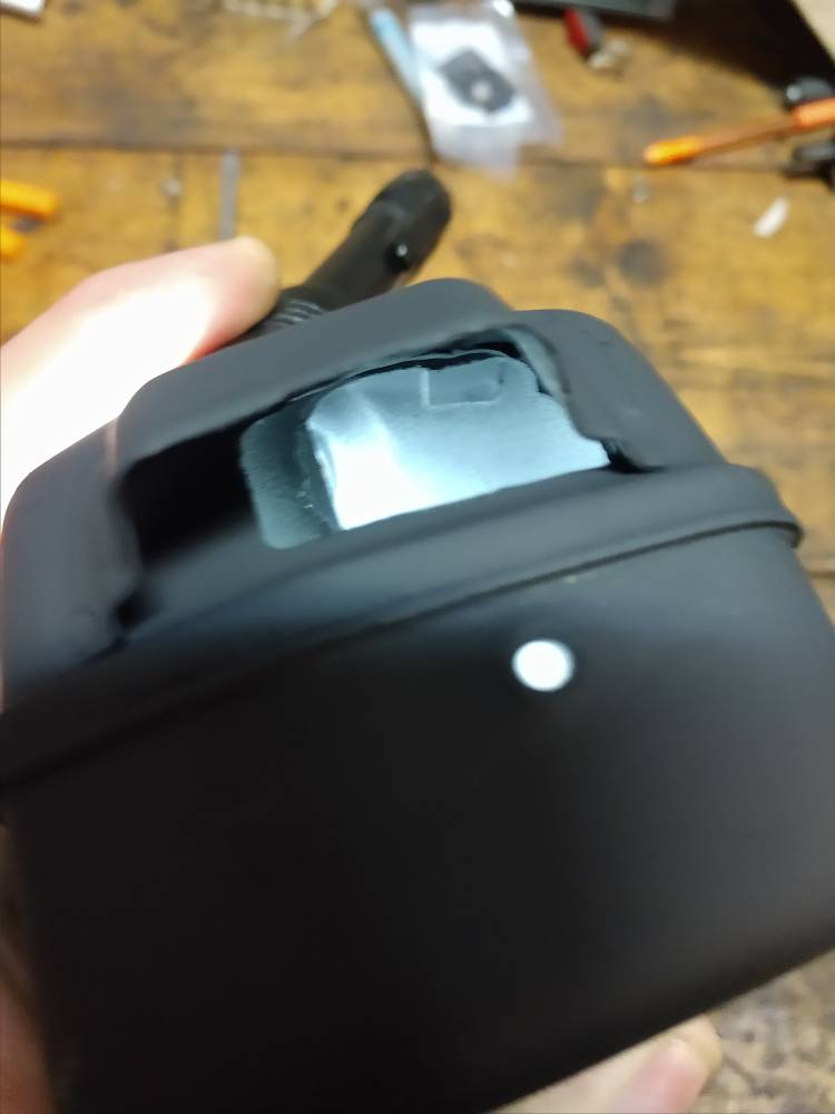

Im gonna try to whittle a hole through the baffle before we install this one. Seems like the 55 I had way back was a two piece muffler?? It has been awhile though...
I'm going to add a second deflector in front of the supplied one.
one of your'n deflectors.
It'll allow me access to cut the box out.
Good luck pulling this previously 2 piece muffler apart.

This should be open enough for the 55.
