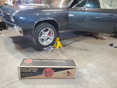

My Chevelle pretty much sat idle during deer hunting season.
Back at it now.
I can't find any reason the teans shouldn't have 4th gear. I'm still waiting on my service manager and GM to decide if I toss every part pertaining to 4th at it or they give me a new trans. Seeing the trans was out, after the brief amount of driving I did, I knew it would benefit from a higher stall so a 2200-2600rpm converter is waiting to go back in.

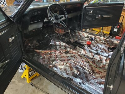

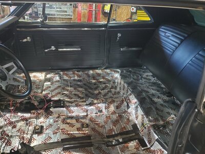

I finished the floor with sound deadening material.
Carpet is unboxed and layed out in there just to let it flatten out from being rolled up before I start fitting and cutting holes in it.

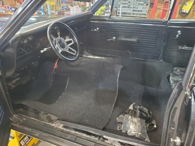

Beginning on the carpet.
I have zero problems tearing into any engine or transmission yet for whatever reason I'm a bit nervous on this endeavor.
Starting at the center, rear per instructions. First cut for the console bracket will now locate it for the remainder of the install.
I used a nail to locate the center of the seatbelt bolt hole. A random 9/16 socket heated up and...
The large washer will help keep the carpet from shifting while moving forward with seat bracket holes. On final install, that washer will go under the carpet on the belts.
