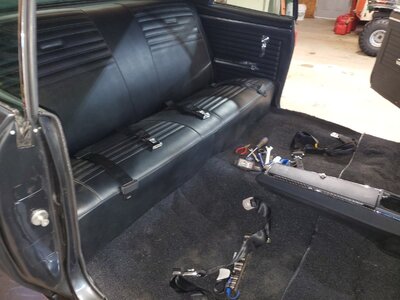

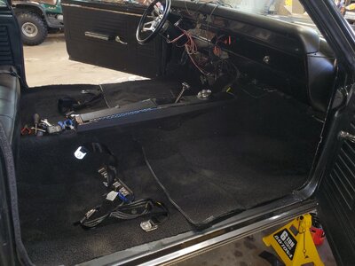

Beginning on the carpet.
I have zero problems tearing into any engine or transmission yet for whatever reason I'm a bit nervous on this endeavor.
Starting at the center, rear per instructions. First cut for the console bracket will now locate it for the remainder of the install.
I used a nail to locate the center of the seatbelt bolt hole. A random 9/16 socket heated up and...
The large washer will help keep the carpet from shifting while moving forward with seat bracket holes. On final install, that washer will go under the carpet on the belts.

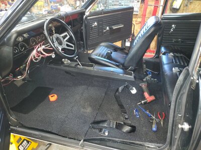

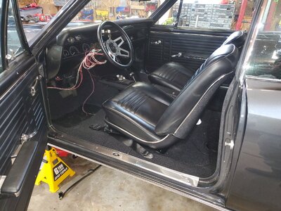

So far so good. Only spot I'm not happy with is at the rear of the console, but that will be behind the seat.
Door sill plates are on order.
Once it gets warm out, I'll get out the heat gun and smooth out any bulges or wrinkles. The instructions say most will flatten out on their own with temp and time.

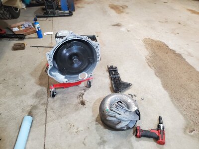

Chevelle transmission part 2, take 173,890.
New converter should stall 2200-2500ish.
Back in..

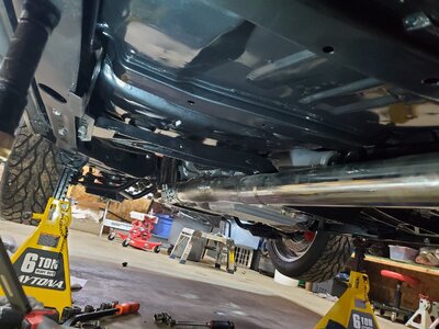

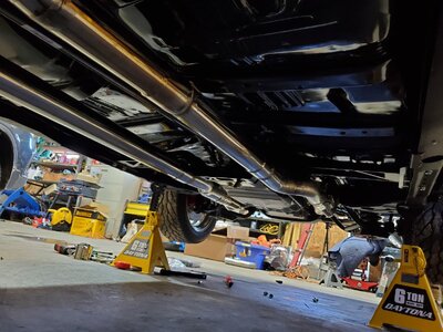

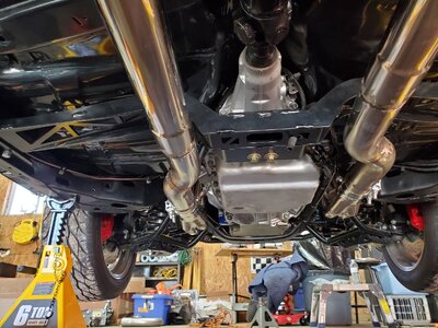

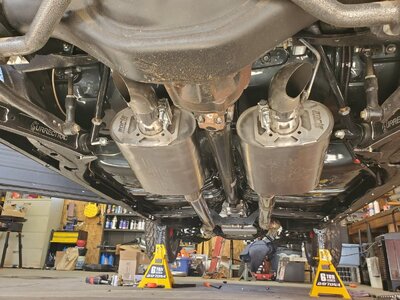

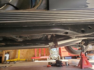

I had run ran straight pipe to the mufflers to get it moving last fall. Mufflers hung super low so I'm working on getting the exhaust tucked up better.
It's not the prettiest but it will be functional for a while.
