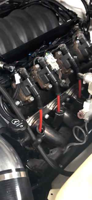

@Canadian farm boy what are you using for plug wires on your car? I'm leaning towards a set of Taylor spiro-pro. They specifically say for engines with headers and their boot design looks like it will give me the best clearance.
That's without spending over $300 on a set of Granatelli wires..
I believe I used a set of 10” 8.8mm Taylor wires and added the thermal sleeves for a little more header protection.IMG_5520.png
