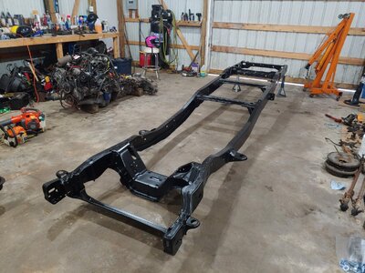

Had to cut way more than anticipated...
I was able to just fold down and flatten out the radiused portion.
Engine now sits down properly on the mounts.
And the bellhousing almost clears the tunnel that has taken a beating from me trying to fit this thing...
Once I get everything clearance, I'll pull the engine for hopefully the last time, box in the cuts in the frame and paint that area.
View attachment 432487View attachment 432488
View attachment 432490View attachment 432491
