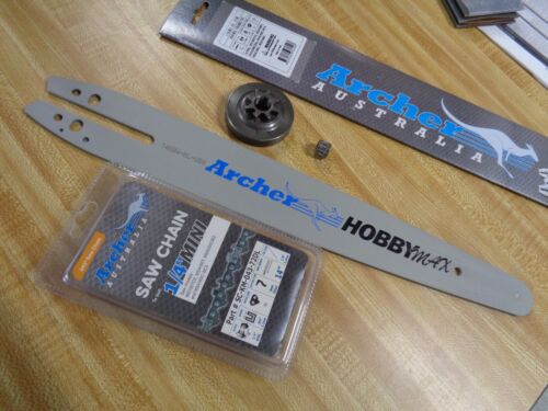

Well fellers, I'm at a loss. Is there a bar and chain in 1/4 14 that works out of the box? Other than panther. Bar mods I can handle. But adding/subtraction of links I don't have tools for... I'm the proud owner of a MMWS cs-2511t, and it came with the 1/4 sprocket. Apparently my weekly visits to what I thought was my stihl dealer, and the thousands I've spent here, don't grant me a little creativity on their part. I was blown out the door...

Just get a stihl one and drill new tensioner holes. Just trace the echo bar onto the stihl one. A 1/4” tile bit and slow speed drill press will get it done.
Edit: Or there’s a cheapo option.
I was at the dealer trying to figure that out... There are 050, and 043 GA bars. The guy wouldn't let me figure out which setup would work with an off the shelf chain. That's strike three with them. Not my dealer anymore. Anyway, the 043 gauge would be a precision cut for pruning. Narrow curf.

Get the .043 1/4” semi. Bar should be around $40, chain another $30. The bar and chain are the only thing the 151t has on a stock 2511t.
Chances are that cheapo option won't last any worthwhile amount of time. Chinese laminated bars have a very loose gauge tolerance. The Archer chain has no safety bumper links, but their laminated bars are junk.
