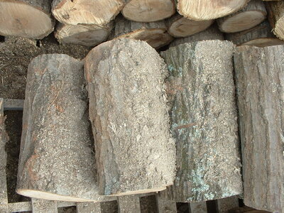

I cut cable skidded logs almost always. Technique was mentioned but never really explained well.
I plunge cut almost every round using 404 semi chisel and a HARDNOSED bar as it bores much easier than a roller tip. Start at about 2 O clok position just below the top of the log, plunge until the tip is very near the far side, cut all the way to the bottom, then push the tip through and throw all the dirt away from the power head cutting the top last. The added benefit is you will never pinch the bar on a big log either since it is still attached at the top.
Too bad this guys is just demonstrating on pecker poles.
Typical log landing wood.
